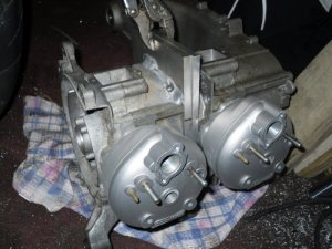

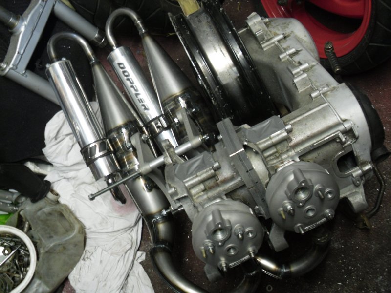

Here's a few pics of my latest twin engine that I'm building, based on a nrg motor. Two Doppler S7r barrels, Doppler full circle cranks, I'll be using Doppler s3r pipes running on std 17.5 carbs. Just waiting for some machining from an engineer and it's almost ready to build up. Just need a Mc3 to put it in! If you know where there is a good nrg for sale let me know.

sick mate ! Looking forward to what this is going to be I got a Mc3 Frame left over but its already cut off on the back end. hit me up if you're interested

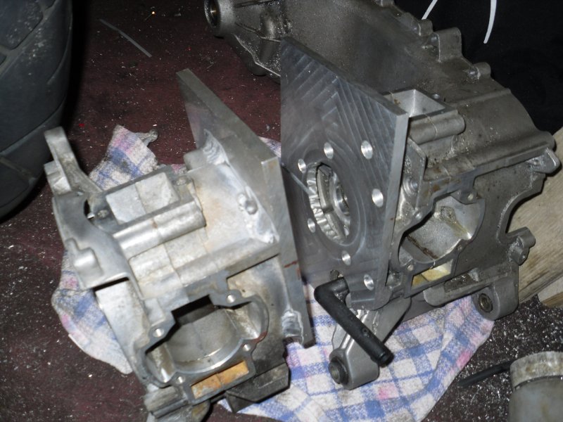

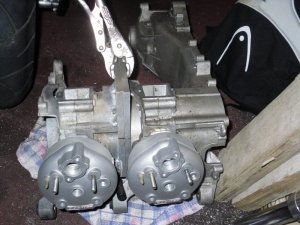

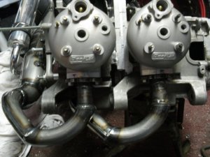

I did a lot more on my old 250 twin, much better to get the machining done by people who know how to machine/weld things properly! I'll just build it up when all the bits are done.

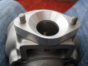

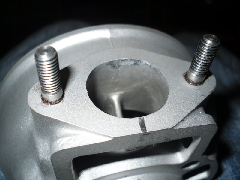

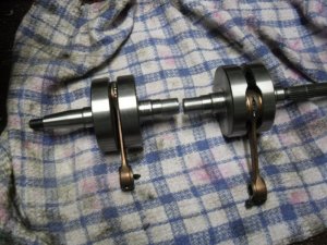

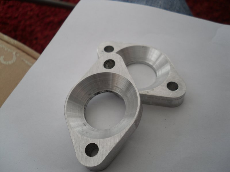

Just a little update on the twin, had these exhaust flanges machined up, as you can see, the Doppler barrel has flat exhaust face where as the the doppler pipe and std Piaggio have cone ends. Just need to fit longer studs ! If anyone want's one then just let me know. ps, I've fitted the cranks with my joint and it turn's over perfect!

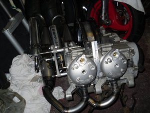

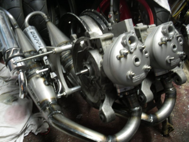

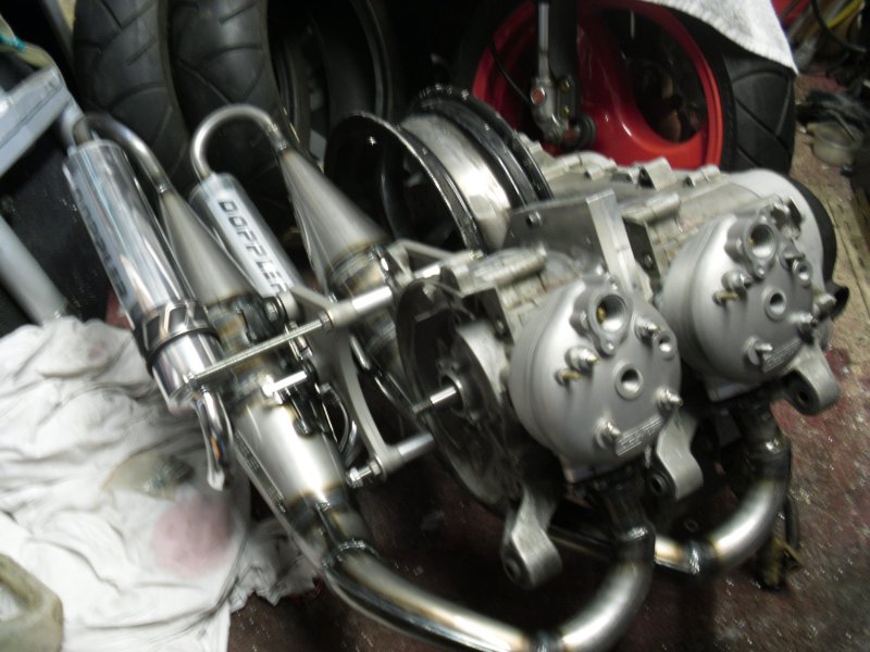

Finally got the pipes measured up and fitted, only needed a couple of tiny alterations to fit! It look's wide with the pipes side by side, I'd have liked the pipes "stacked" gp style but when fitted to the NRG frame I think it won't be to bad, probably 6-8" wider. Getting there slow but sure. I'm still looking for NRG Mc3 for this project.
Just a thought about the pipes...............what about a two into one instead of two complete systems?
