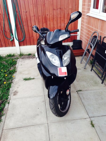

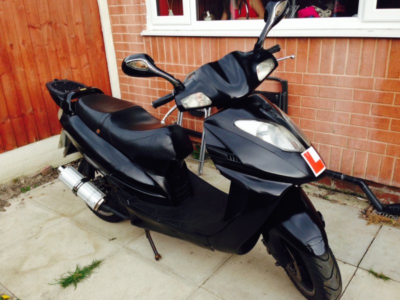

    hello lads i finally finished spraying my bike yesterday. what do you think? image(3).jpeg image(2).jpeg
  15. hairyjim
    1,229
    Got a gilera ice
    mmmm.wheres the tissues.very nice.ide be happy riding that
  16. Merlin
    Merlin Old School Biker
    2,305
    2007 TKR WRC 50
    /drools...
  17. Kev Clark
    Kev Clark Member
    289
    Lexmoto Zoom 2 125
    Thanks lads! Mean a lot
  18. ginge
    ginge Active Member
    589
    Looks like your choice of laquer worked out nicely in the end :)
  19. Kev Clark
    Kev Clark Member
    289
    Lexmoto Zoom 2 125
    Yeah it come up pretty good in the end mate! A lot of hard work and patience, got there in the end tho
