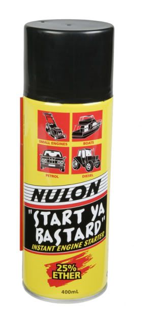

    try some of this...guarenteed to work :grin:
