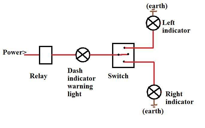

    it was a losse wire on the coil so thats y it nealy started but its fine now the only problem is now is that when i put the indincators on all 4 come on and flash at the same time y this

  6. wobbly_trials
    you have the light on the dash wired wrong.

  8. wobbly_trials
    right you wired the lights in, it should go:
    power->relay->dash light->Switch->left indies or right indies
    i think yours goes:
    power->relay->Switch->dash light->left indies or right indies
    EDIT:
    this is how it should look:
    i beleive you have the dash bulb wired in after the switch somehow so it is acting as a bridge between the 2 sets of bulbs and so making all 4 live.
  9. lol
    lol New Member
    964
    ok yh great help ill have a look to moz cheers
