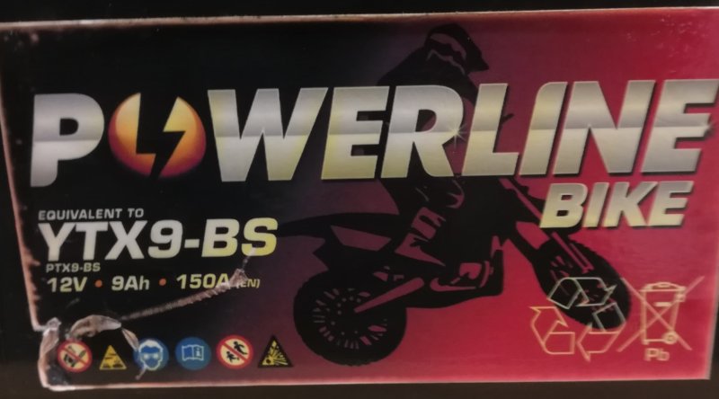

    ive tried to upload a pic but the file is to large

    I've now uploaded a pic of the battery label
  11. scubabiker
    Never even heard of that brand before.
    Try a new battery.
    If it's still giving you trouble I would be looking at the starter motor or starter motor cables.
  12. allan campbelo
    allan campbelo New Member
    14
    it's a powerline battery from the internet
    i will get a new one.
    cheers

    had the battery checked out and its OK.
    holding 12.9v and cranking amps 150
