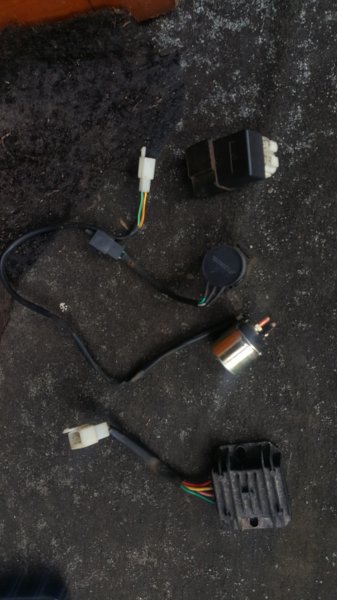

    Pulse lightspeed 2 ...... can't get a spark ??? Changed parts one by one but nothing ... what next 1472981959725-178929085.jpg 1472981959725-178929085.jpg
  2. Stevep
    Were the parts changed for either new or KNOWN GOOD ONES?
  3. Stevep
    Have you checked the engine earth?

  6. Stevep
    there is normally an earth lead going down to the engine itself. Frame to earth.
    The pulse is created when the flywheel passes over the pickup, part of the stator assembly, which sends a signal to the cdi to tell it to send a spark. Could be the pickup itself or any of the wiring down there as well.
    Or the coil/coil connection/lead/plug.
