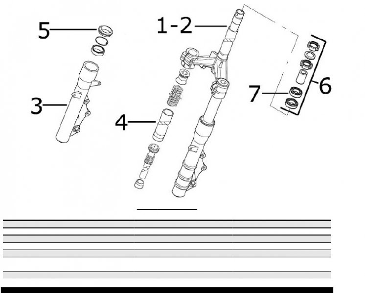

    as you can see from this photo the forks are the same design as a push bike, I think you are right scubabiker its the top stem or frame
    as to the engine mounts they are ok well tight anyway, if the engine when put in had more spacers put on one side rather than equal amounts that may twist the wheel alignment
    the owner don't seem to notice the scooter s handling but I wont ride it again, so down to what he says
