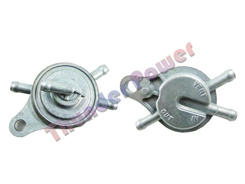

    its a 50cc scooter with a vacuum fuel tap which is perished. i have replace the fuel stopcock with a diffrent one with 4 outlets but i cant seem to get the right vacuum source as when its all connected together the fuel will come out from the vent port on the fuel tap or it will keep flowing out of the carb were the air filter would be.
    attached is the new fuel tap and what pipes are from the old one

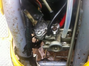

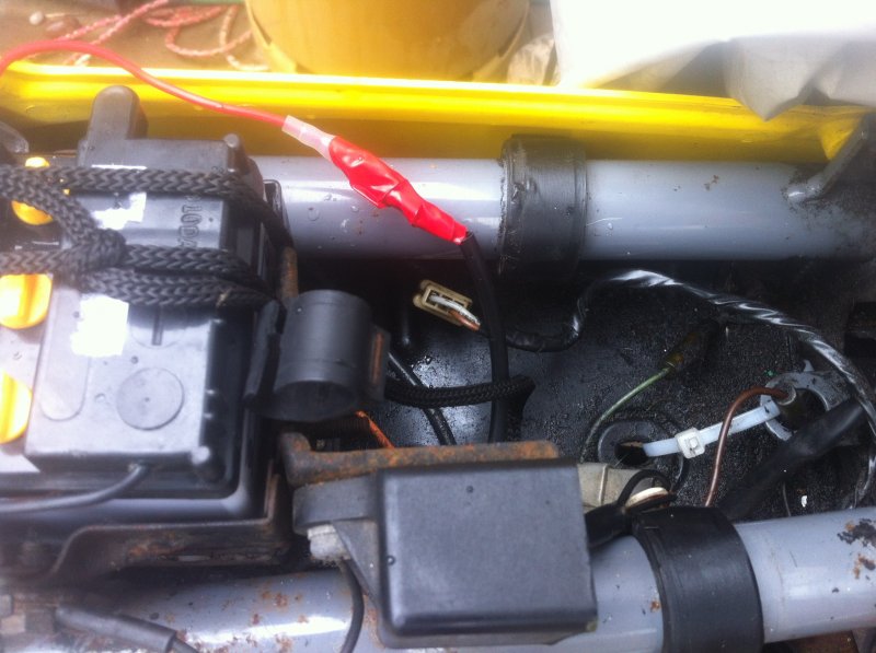

    here are the pic like i said this is my first scooter how would i check the engine bushes and were should the vin be?
    i have the red pipe going to the vacuum fuel tap when i suck the red pipe it allows fuel to flow when not connected to the inlet on the carb but when its connected it seems like the fuel doesnt want to flow and comes out of the vent

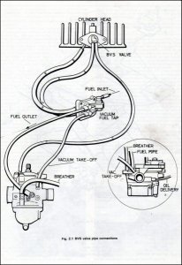

    cant seem to edit my post the thin black pipe is going straight to the head as in the (c) pipe on the pvs picture above. its just the a and b ones as you can see there is two left on the cylinder head and also 1 left on the carb which i belive is oil feed? as the oil tank has been removed i have been premixing fuel and oil
