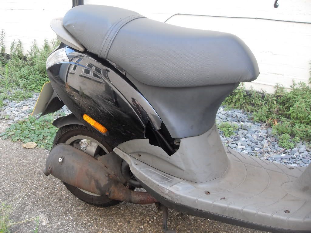

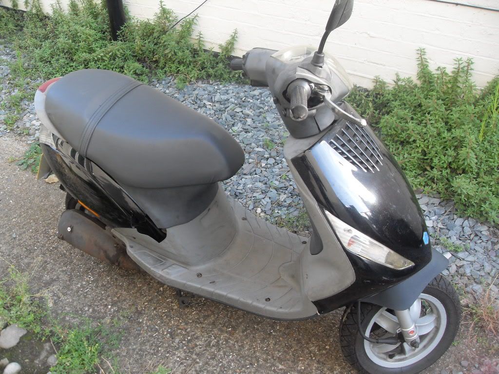

    Bought a 01 piaggio zip 50 of ebay for £200. Everything is standard but i think its got a vespa exhaust.

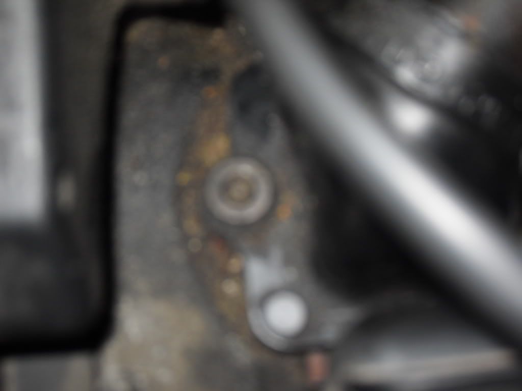

    Does anyone know how i get them bolts off on the manifold?
    Does anyone know how i get them bolts off on the manifold????

    yes you unscrew them :confused:cratch:
    if you meen your cant because there hex screws then you have to buy the hex bit that fits

    yh they look like the alan key bolts but its got a bit in the centre (so obv the alan key wudnt fit) i jus need to know whats the name of the tool so i can get it off

    i torx keys :thumbsup:

    if you wanna be bodge you can hammer a flathead into it and unscrew it

    the fittings are security torx. You can get the proper tool as part of a set from places like screwfix or machine mart...around a fiver for the set

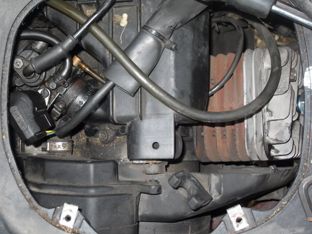

  15. MiNoR cOnFuSiOn

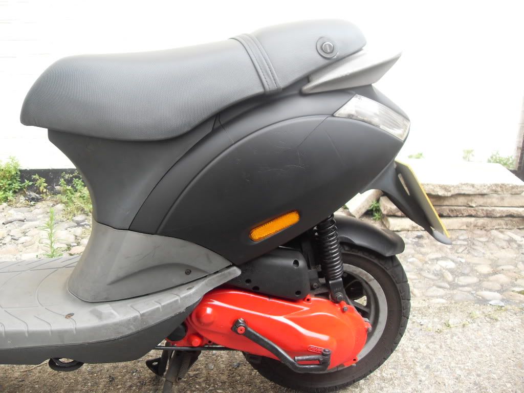

    just spotrted an engine cover missing in one of the pics... this WILL make it heat up and cause the "bogging" find/buy an engine cover. it needs it to keep cool

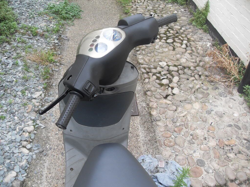

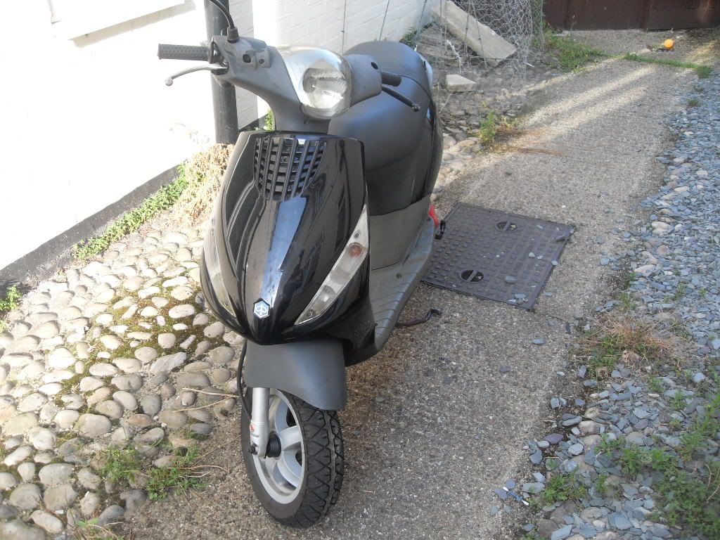

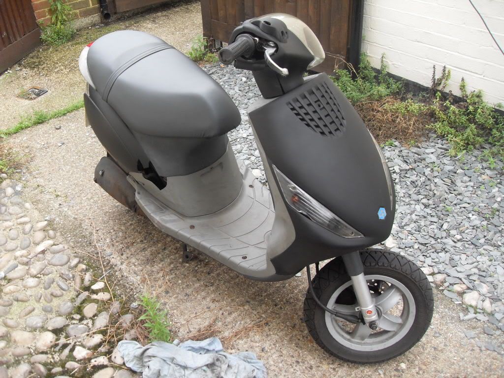

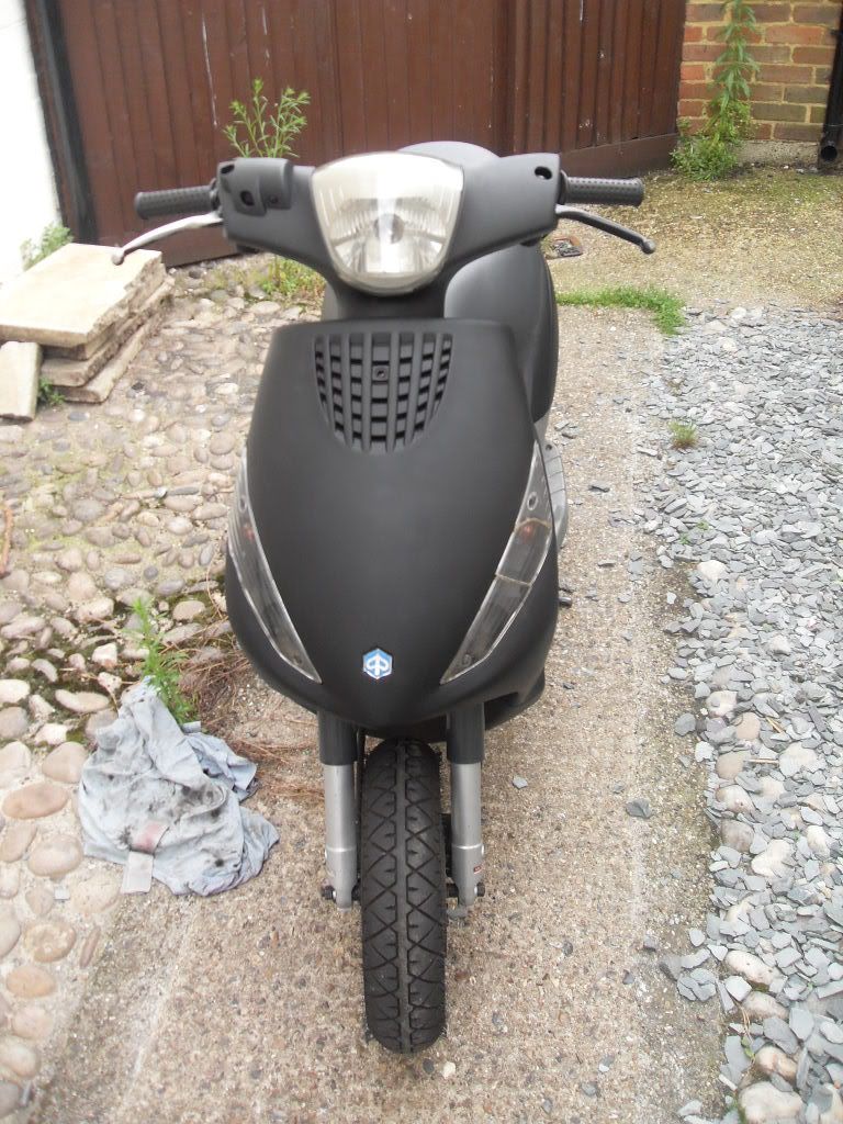

  17. typh-gilly99
    typh-gilly99 Member
    273
    Typhoon 125 2T
    Back now, and the sanding, priming and painting has been done.
    grey primer and matt black used, i might add another coat of matt black and spray over in clear laquer.
    Heres what it looks like.
    TOOK THE FRONT MUDGAURD OFF
    I am going to polish my case this week.
  18. PrettyDodgyDave
    PrettyDodgyDave Member
    975
    Runner 180
    why did you just spray over damaged pans?
    should have filled/fibre-glassed them first woulda looka a whole heap better??
    anyway i love matt black so good choice of colour :mrgreen:

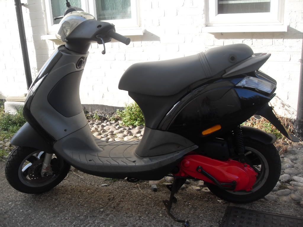

  20. MiNoR cOnFuSiOn
    paint is only as good as the surface it sits on, front looks nice, but ye, batt black zip. they look good, but nothing new.
    whats with the red tranny cover? :confused:
