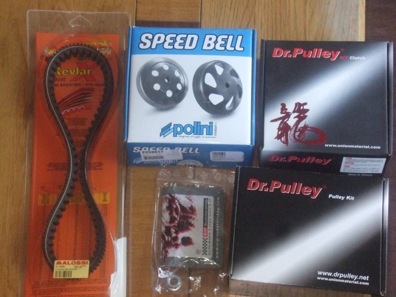

    Hi guys, my Dr Pulley Variator and Clutch have arrived Today. I understand that the variator has different dimensions compared to the stock one. Stock (21x17) and dr pulley (20x15). I currently run 10g stock sliders and have wicked acceleration but it gets tired past 72mph but still hits 88mph or so when flat out.
    Dr Pulley Variator comes 12g and 13g sliders. I am wondering if I should but 10g again or maybe they are the best weights to use on my model to achieve best acceleration/speed combo (as in lighter will be too snappy to ride...
    The whole ride is going to change with the Variator, Clutch, x kev belt and new speed bell so simply put it, there is no answer and it is just about finding the sweet spot between the variator and clutch set up more than anything else? Oh! and dropping into a mechanics who deal with scooter mods and this kinda thing is common as muck for them. Will let them keep it and test it till it runs smooth.

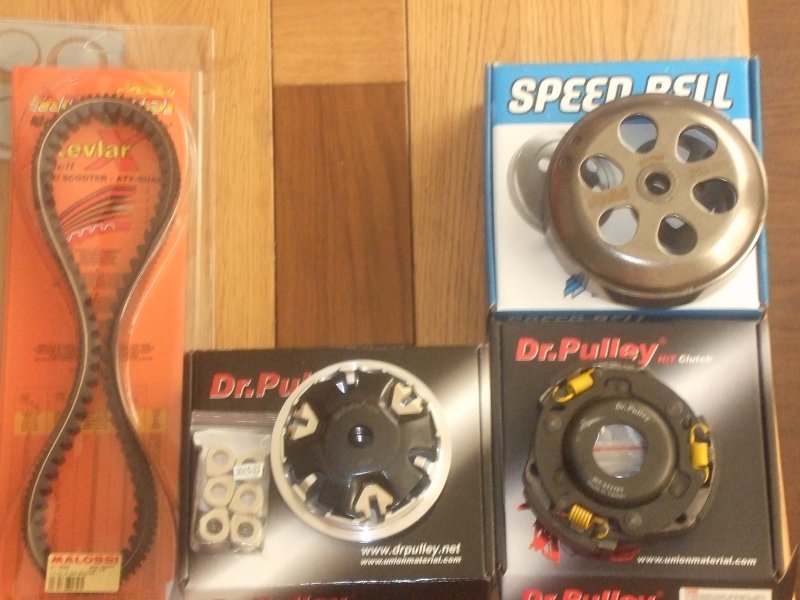

    Well here they are! Installing the lot next week.
