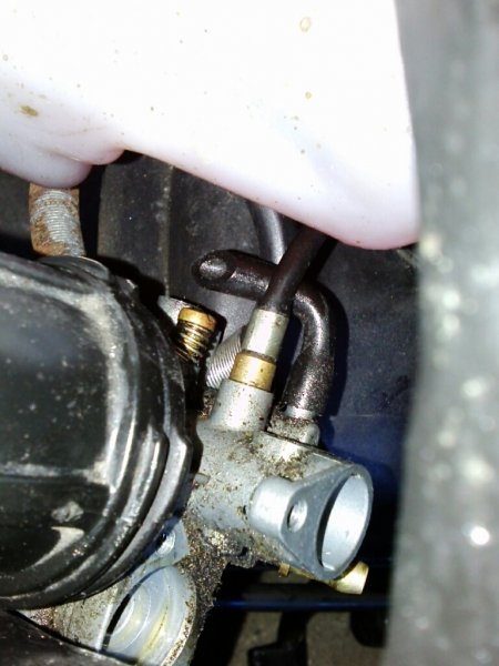

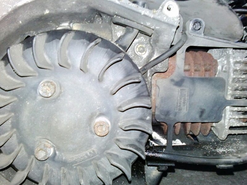

    Im in the process of taking the old carb off. Its a Gurtner PY and ive found a hose that looks like its not meant to come off. It runs to behind the fan. Any idea what it is and can I cut it off and attach it to the nipple of the new carb?
  4. hairyjim
    1,229
    Got a gilera ice
    that pipe is meant to be like that.you could make it longer and tuck it away..cant remember if its a breather or over flow but its extendable.
