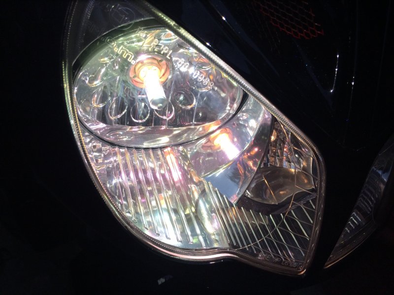

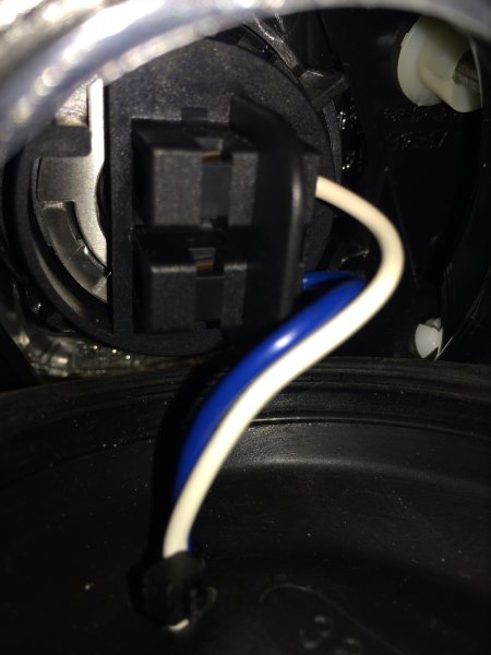

    This is the back, obv pretty simple, cant really do anything wrong... and a pic of the Bulb actually working...
    I checked the 2 Bulbs (old and new) and both are the same, H7 12V 55W,
    so why the clicking/ticking noise all of a sudden from the Battery?

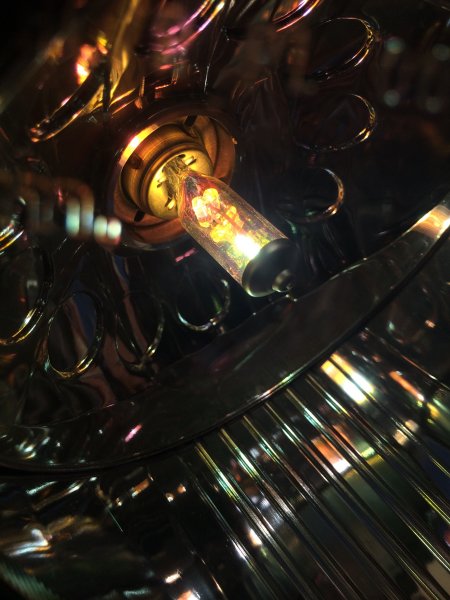

    This was a weird one, yellowy at the base but white at the end :-/
    sending these back anyway, bought 4 of them,
