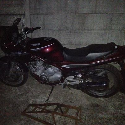

    hey ppl bort a yamaha xj600s 1996 yesterday problem is it wont start found out its not sparking lucky me just checked the coils there fine loom is fine starter motor fine spark plugs fine
    anyone know what could be stoping the spark n light is on so not in gear
    if not might have too find A
    auto electrician thats not going to be cheap or sumone who knows about bikes

    here is a pic

    some Yams (mine included) have a side stand switch to cut the engine if the stands down and its in gear. When they go faulty it affects the bikes starting.
    Trace the power from the ignition and see how far it gets. Could be something as simple as a faulty kill switch
