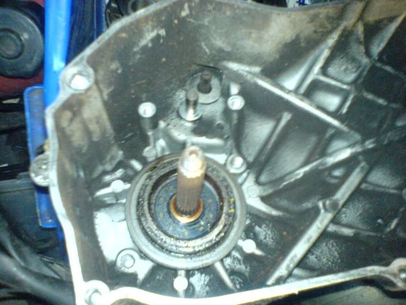

    need a picure of the way the starter motor and flywheel fits.. so a pic of inside the transcase without the vari in

  2. wobbly_trials
    thats the best i can do at the moment, you need to put the spacer in, sprag clutch on, possibly another spacer then the variator assembly. can't remember off the top of my head.

    i can do tha bit.. its the way the little starter motor plate (like a banana shape) fits

    aah, put the spacer in (thick washer), then put the cog on then put the banana shaped thing on with the ARC upwards so that the little recess in the middle goes over the starter dummy gear shaft. (the one sticking out between the 2 bolt holes).
    i cant remember if some had 2 of the spacers or not. i would have to take the area motor back apart as its a while since i've done a minarelli bottom-end.
