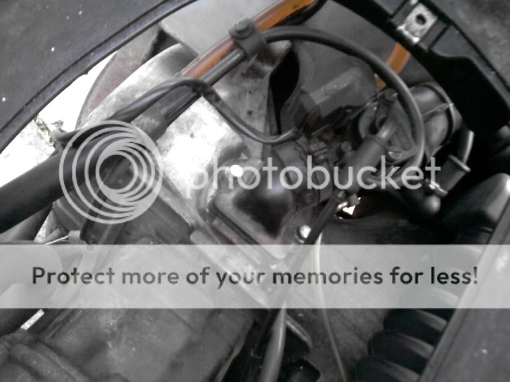

    as fair as i know the reed is all good and the in let rubber has go a crack but it not anything mayjor i check see if i could see througth and cant ill put up pics one sec

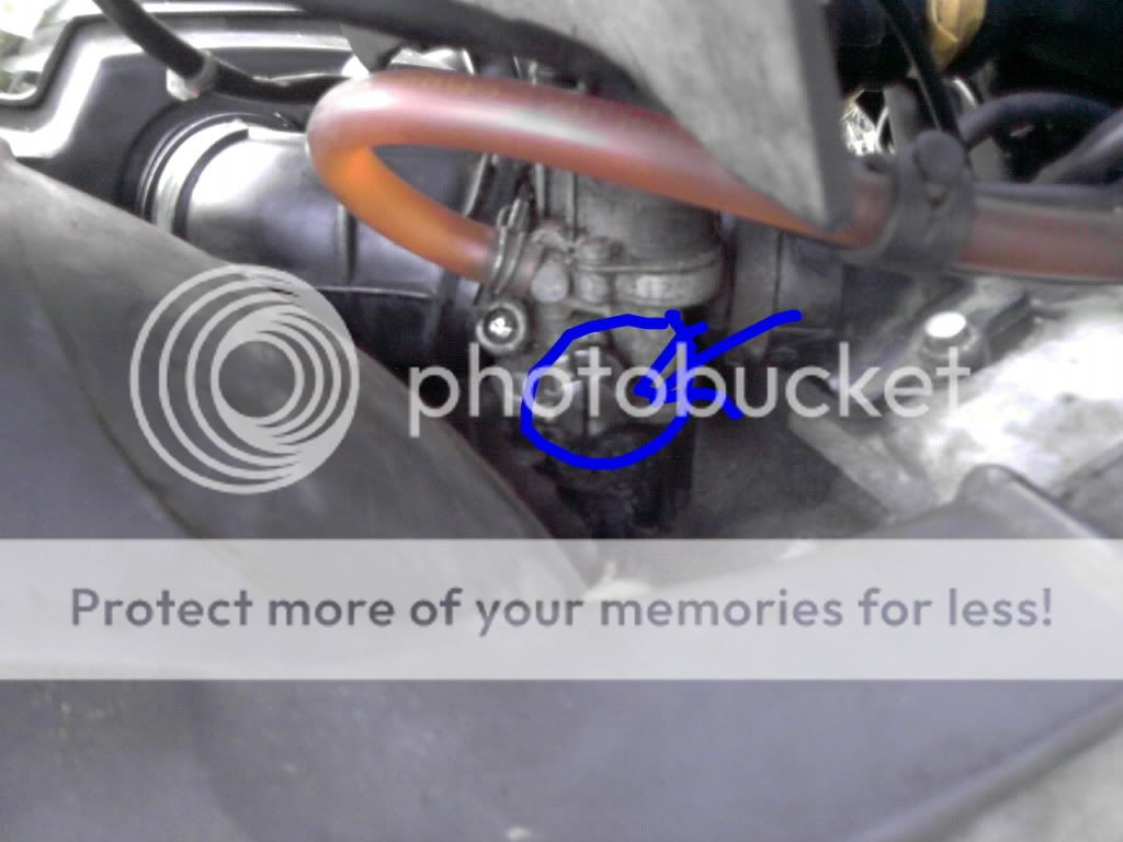

    well im not sure where the idle adjuster screw is but thereis smethingup with my cable some where like i said i have some control of my rev for two secs but then went high agin.

    the idle screw is the one you circled mate and the thing next to it is an air/fuel mixture screw but on them carbs its like a blanking plug.. it could need adjusting..are your jets clean??

    u sure it not the other way round cuz i pug my finger in the plug hole and i twist that big one and i get more fuel the tighter i twist it??

    check your throttle cable aint sticking,air filter off twist the throttle all the way back,looking in the back of the carb let go the throttle slide should drop at a good rate and make a thud as it hits the idle speed screw,thats the big one.. do this a few times to make sure, drop the float bowl off the carb remove the jets, make sure they aint blocked and everything looks ok..put float bowl back on.
    While the carbs off remove the inlet manifold and reed block, check the reeds are good, hold the block up to the light there shoulden't be any gap between the reeds and the block.. have a good look at the manifold,clean all the mating surfaces.. all ok reinstall , use some gasket sealent.
    Refit the carb everything tight ok.... set the mixture/air screw 2.5 turns out from fully in as a ball park figure. fire her up. :grin:

    on ur other thread i swear u said u took a throttle cable from another bike and put it on the runner n now the slide is not sitting properly..not starting on its own and not idling obviously...buy urself a new throttle cable that is actually made for your bike :confused:
    the big black screw wouldn't chande an thing because the slide is raised way above its operating area,,,its there to fine tune the position of the slide for idle speed...

    ill have to show u the i can see througth my carb one side to the other with out twisting the throttle ??
    ill pull my throttle out and show u what i mean also ill take a pic of the carb to also show u what i mean
