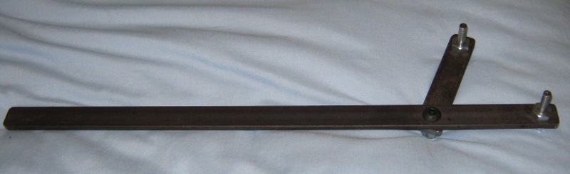

    Heading home on a 70 mile round trip still around 15 miles to go and the thing sounded like a chain saw, I thought that cant be me. yep! pull over quick and kill the engine. It would free wheel OK with no noise but start the engine and there is a clatter of metal on metal. Pushed it a mile or so before giving up and asking a guy if I could borrow a few tools. Took off the side cover and found the variator loose and the fins catching the plate around the kick start. Still no 19mm spanner to tighten it up but an adjustable spanner. Did it up best I could passed back the tools and left the side cover off, managed 1/2 mile at most when the variator side with the fins is rolling down the road, the nut and washer gone for ever.
    Nothing else for it but to push the bike a bit more until I decide I can leave it in a small estate, chain it up and call the wife for a pick-up. That's another thing I will never hear the last of.
    Home for tea, time in the garage on the lathe and make a universal holding tool, bits off the seized engine, lock-tight and back out courtesy of the Mrs back to the bike. 15 minutes later on the way home again.
