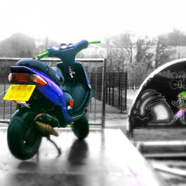

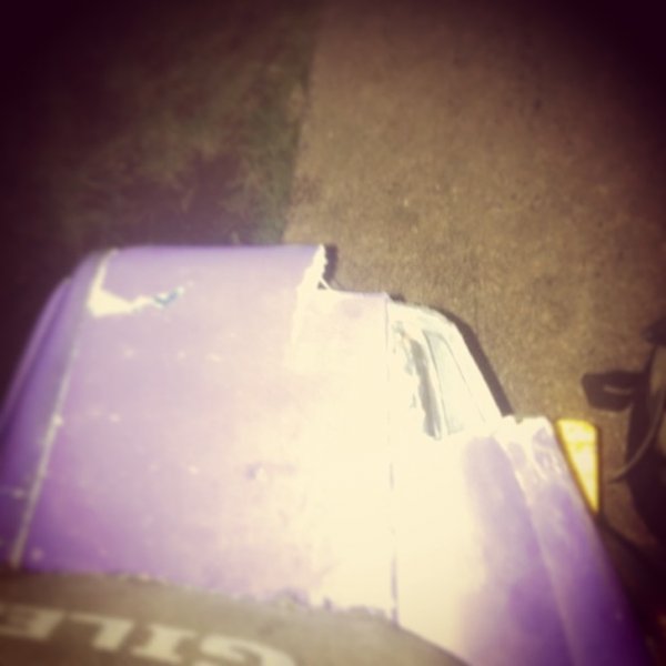

    after selling my speedy i decided to go for something a bit different... so here she is
    with my speedy :(

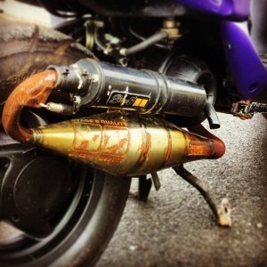

    54 plate gilera stalker with a stage 6 pipe, 62 main jet & 5 grom rollers ...but i need your help, with my mates bikes and my speedychanging the pipe and lighter rollers made them so much quicker but this one is still really slow? any ideas? i did not fit the pipe or rollers its how i got it... also has anyone got any ideas about carb settings on these?

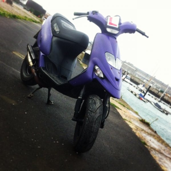

    my plan is to re spray it Black panels with either red, purple, orange or blue wheels and other little bits... get some carbon reed & a malossi air filter for standard air box then at some point a 70cc kit :)
    follow this thread :D cheers
    kieran

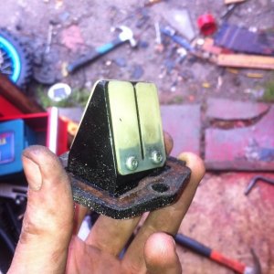

    sorrted my running problem, replaced the 17.5 delly carb and filter with the older 13 mil webber one and air box, replace my standard reeds with some thinner plastic ones and another clutch with a softer spring as mine was solid... carbons after xmas :)

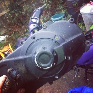

    drilled out side casing for extra cooling
    also... flipped it doing a wheelie :(

    I like the purple, isit that matte?
