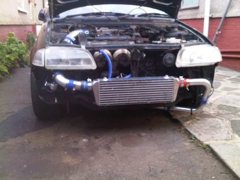

    heres my swift gti that ive turboed only running 175bhp flywheel but at 735kg she dont go bad hehehe i have another project one wich is 4wd and hoping for 300bhp plus gas :grin:
    cheers steve
  2. PrettyDodgyDave
    PrettyDodgyDave Member
    975
    Runner 180
    Big fan :D whats the spec?
  3. stevegti2
    stevegti2 Member
    169
    cheers completly standard engine 150.000 miles lol these motors were built so well
    ihi vf38 turbo running 10psi
    2.5" exhaust with middle and back box
    gineric turbo chip in origanal ecu made by a mate of mine in australia years ago
    gear box
    4 puck clutch
    3kg billet flywheel
    cusco lsd
    koni shocks
    custom rear springs
    spax front springs
    thicker anti roll bars
    hankook rs2 ytres
    errrr evo 4 sears some harnesses yada yada yada lol
    this is just my run around i have another one im building more for track and its 4wd :grin: this still goes well my mates evo was dynoed at 330 bhp (whp) im leval until 3rd and 4th then he just plain has more power lol but corners im up his ass love ma tin lol

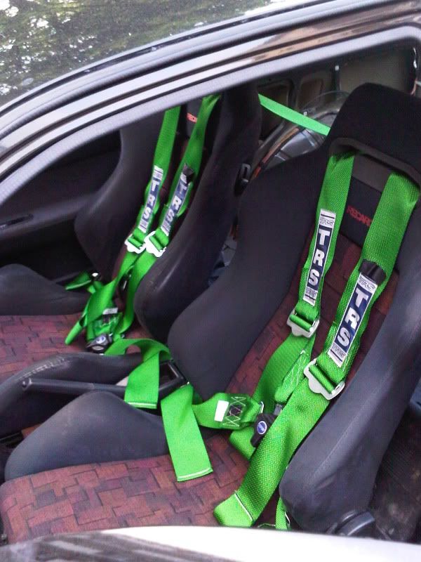

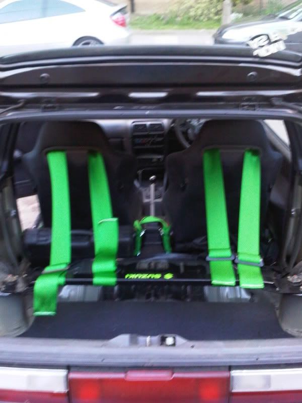

    one thing I would say though is harnesses mounted on a strut brace is a big no no!
    should be a properly welded in harness bar as per msa/fia regs ( or even mot for that matter! shouldnt pass a legit one as it is!)
    think of a side impact right into that suspension turret! wouldnt take much to sheer them bolts and harnesses would be floating around doing not alot!
  5. stevegti2
    stevegti2 Member
    169
    lol yea it does mate if you saw the standard seat belt mounting points on a swift you would feel safe in those the side eye hooks are welded to the floor the strur brace is steel aswell and i rewelded the joins i know what ya mean but in all the swifts wrote off swifts etc ive seen i have never seen a suspension turrot top bolt sheer off
