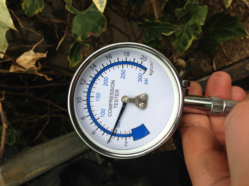

    just did a compression test on my gilera runner 172 here is the results can anyone tell me if this ok or not?? thanks IMG_0089.JPG

    that sounds mega low im sure its 120 ish for decent compression.
    as for the description my runner 172 did the same but would start after the backfire, check your reeds. my carbon reed had snapped into the engine whilst idling. i had to fish it out before it did damage. I would check yours. if it has gone into the engine whilst driving it may have caused a lot of damage to the barrel.
    pop some oil down the plug hole and test the compression again, it should spike right up, this will indicate damaged or worn rings.

    that compression is seriously low , when you took it out did you take it easy or did you just rag it for 20 min straight if so you have probably just fucked the new top end and as cream soda said check your reeds are ok and are not broke or stuck open , my rs50 with fucked piston rings and a leaking head gasket still put 60 psi on the pressure gauge

    nope, as that compression isnt a fueling issue.
    take the reeds out and look at them, simply undo the 2 bolts on the carb inlet and pull it off then the reeds will slide out, inspect them for cracks etc and make sure they are closed, there shouldnt be a gap.
    if they are fine its time to get that head and barrel off i think as somthings not gone well.

    That compression is seriously low ! My Piaggio nrg 50cc pulls out at 126 PSI and runs like a beauty :) As Creamsodauk said, Check the reed valves. However Normally lack of compression is to do with Piston rings or is related to something else. Like score marks in the cyclinder allowing air to go through therefore no compression. Replace the top end and it should work. Well thats if you get a spark of course :)
