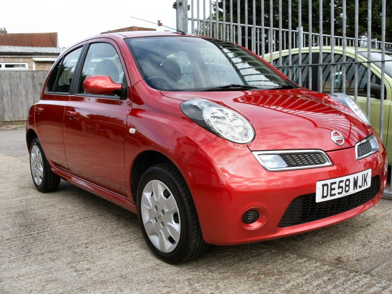

    keep the pictures coming its very interesting to hear about how you are getting on with the car ,you never know if you come over to santa pod we might pop up and watch you run it picture of wifes car nissan.jpg

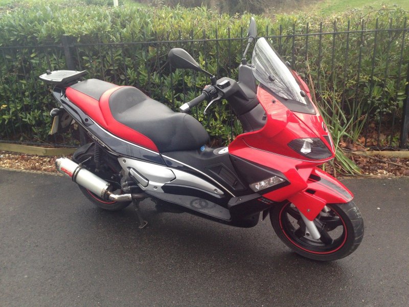

    I have a gilera nexus scooter so I know what you mean,they build a engine then add bits ,so you cant get at anything without dismantling the whole bloody thing
    22000 pounds that's madness does any one own sports cars in Sweden or Norway what with the speed limit road tax inport duty you need to be super rich,how much is petrol and diesel a ltr my gilera nexus 250.jpg

    oh a micra.....
    few things to keep a eye on :)
    headgasket - don't usually like to do more than 40,000 without it being done - good to upgrade to a better one than the cheap standard shit.
    Wheel bearings - they like to go often too.
    The cv boots - the quality is shocking standard and they perish/split easy.
    Gear linkages - Try doing those at home, not a easy job.
    Has the same issue as the Citroen C2 where water gets under the bonnet and gets into electricals, a nice line of black silicone stops that happening.
    Rear shocks - Standard ones aren't the best and theyre expensive as hell to replace!

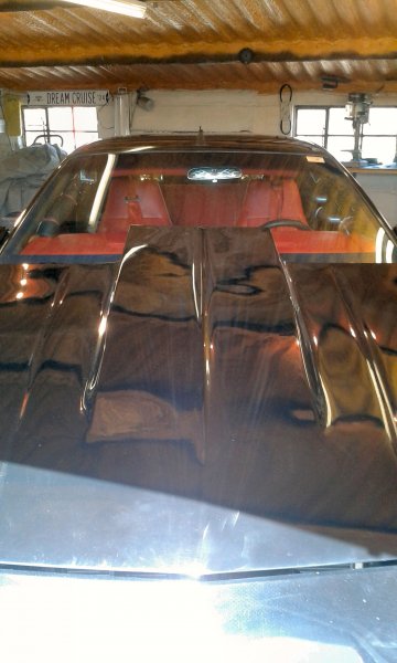

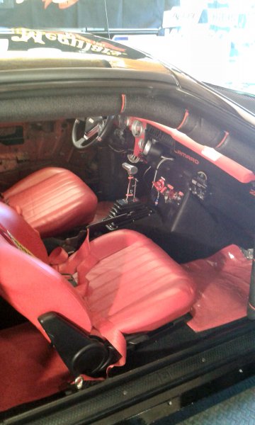

    027.jpg my camero in the next garage to mine ,caught him today so took some photos he said he was going to use it on the road plus santapod, he told me he would nitro it and trailer it to santapod ,as he said if he brakes it you knackered if you drive it to the drag strip
    he changed the interior from black to red , I think it suits the car

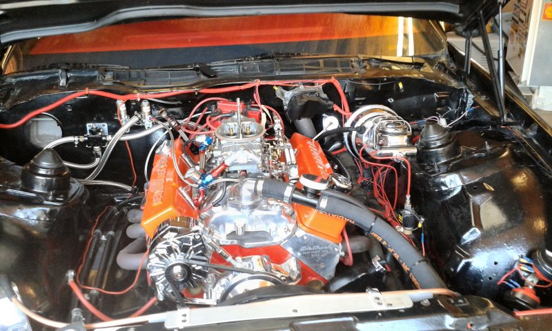

    wish my motor was like that.....
  15. scootzmadness
    scootzmadness Left the forum.
    4,235
    None.
    Can make almost any engine look like that with a engine out + repaint.
  16. scubabiker
    scubabiker NITROJUNKIE
    7,321
    i meant the easy of getting to it all. i will get a pic later of my engine bay and you will understand

    scubabiker can you help the chap with the camera at my place hes got a new engine new rad ,but his car blows water out when it gets hot,hes taken out the thermostat its got us stumped.any help would be greatly received
  18. scootzmadness
    4,235
    None.
    remove thermostat. test it in a jug of BOILING water. if it doesn't open replace.
    sounds like theres a air blockage somewhere in the coolant system and he needs to bleed the system so there isn't a air lock.
  19. scubabiker
    7,321
    yeah i would guess at an airleak, or the headgasket has blown. american parts aint the best quality
  20. twodogs
    twodogs Active Member
    497
    scooters
    thanks we took the thermostat out and it still blows he does not want to take the head off ,only if he has to air lock sounds good will let you know the out come 031.jpg
