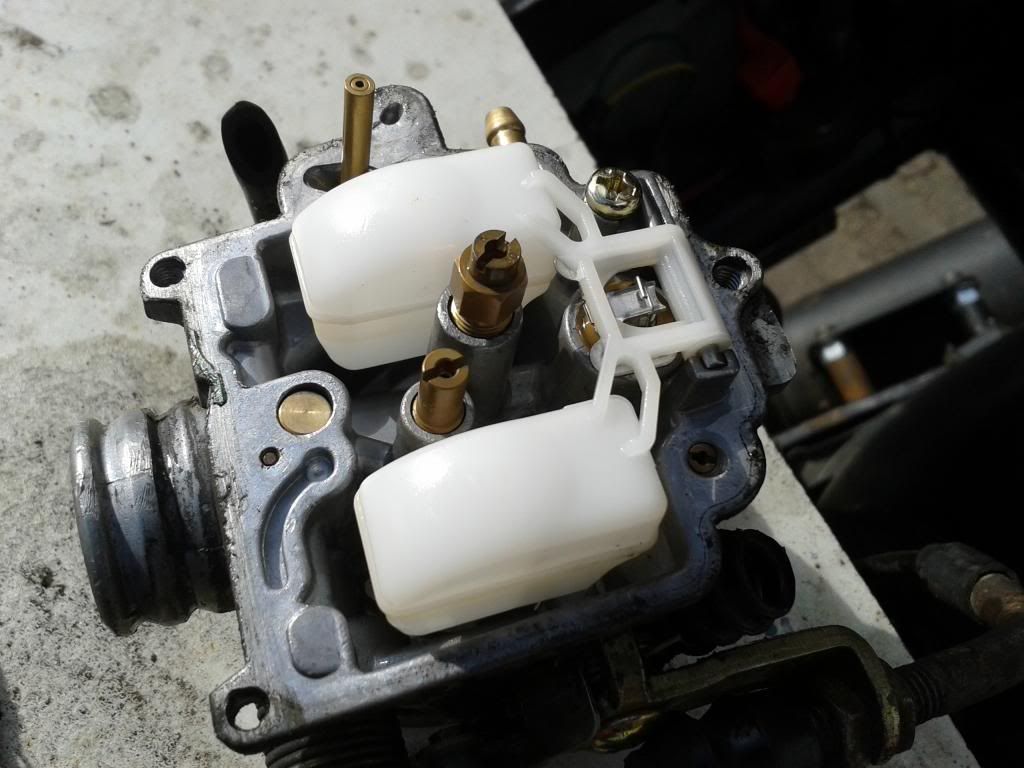

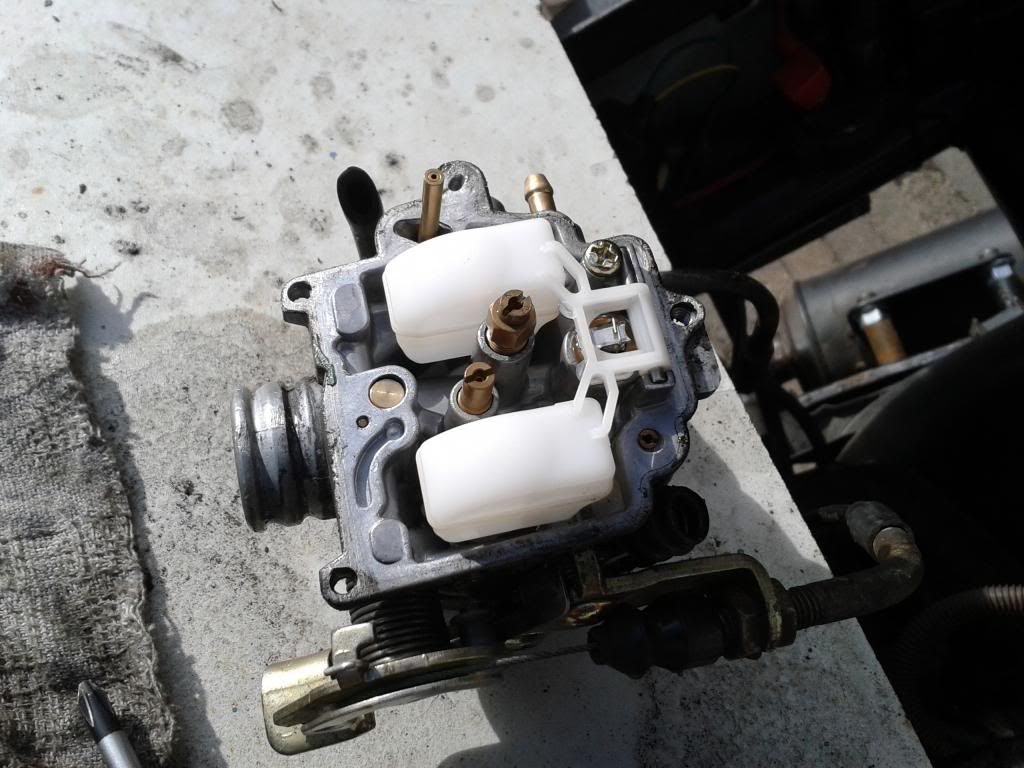

    After having it running, and riding I decided to clean the carb, to be greeted by an unusual site (for me at least) a clean carb ! After putting it all together, it would Idle but not rev... After some tinkering, I realised I had made a stupid mistake, and not tightened the jet properly and it had rattled itself out.

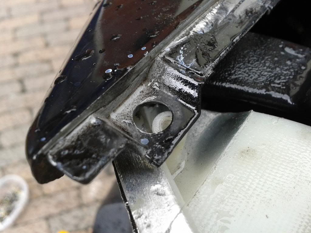

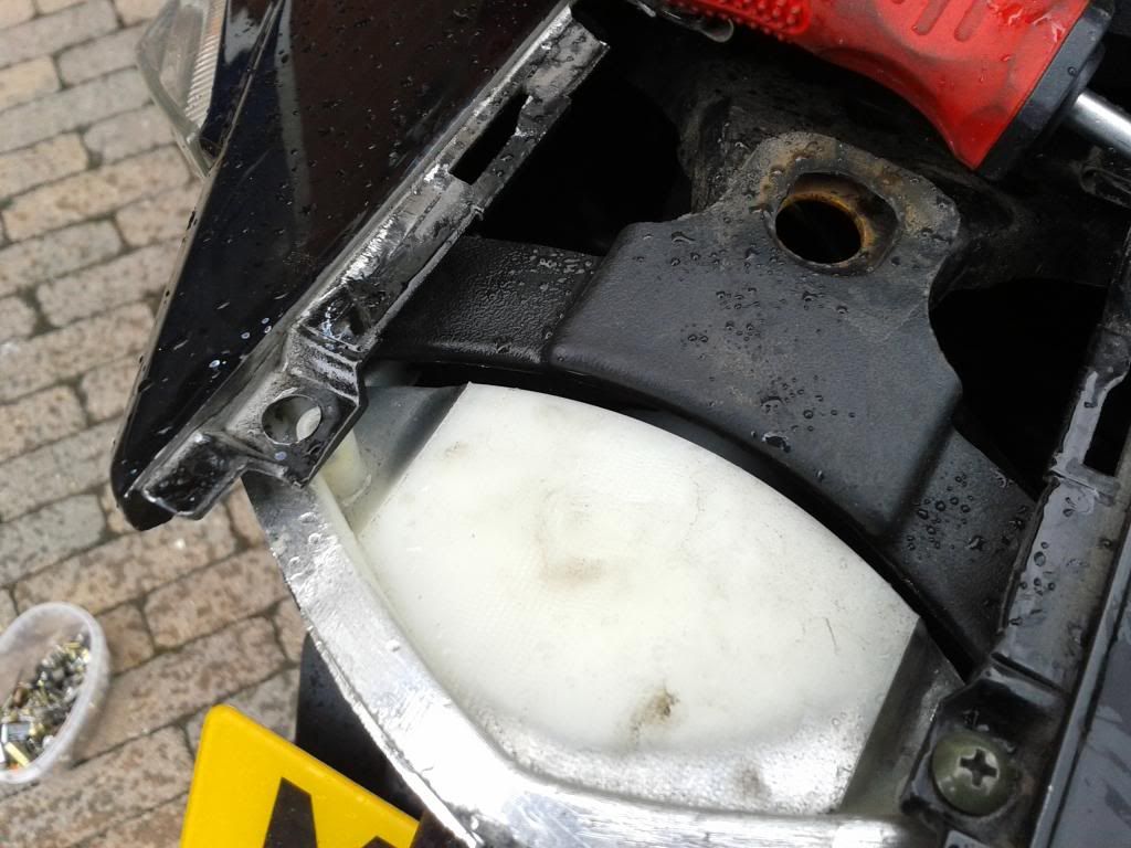

    I also took this time to repair a broken piece of fairing (Where the mount for the brake light screws into).
    Having no epoxy, nor superglue, I had to resort to borrowing some acrylic nail glue from the fathers girlfriend !
    It seems to have held fine so far, But when it comes to painting time I will reinforce it.
