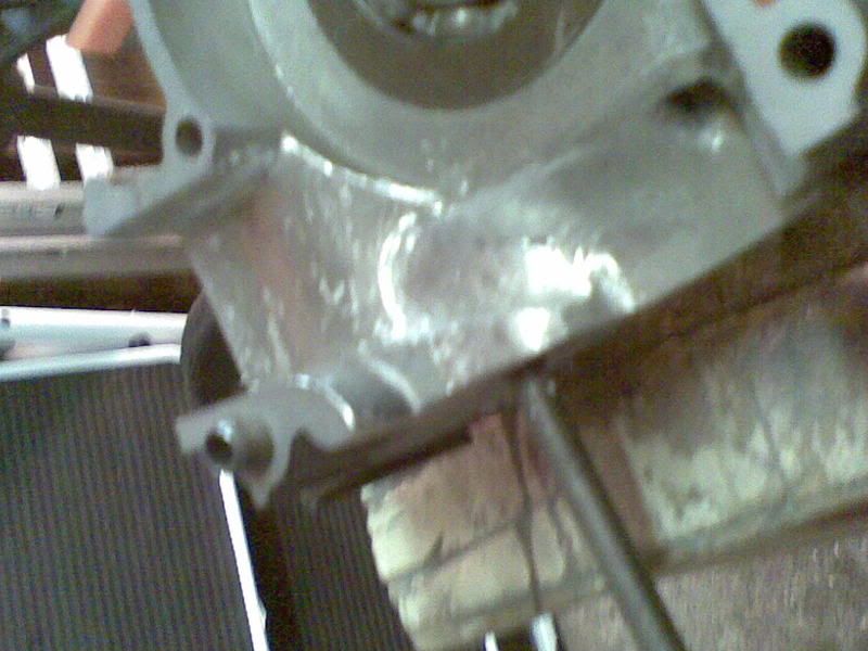

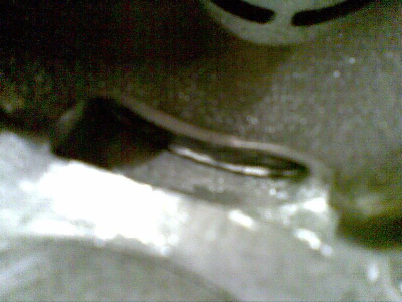

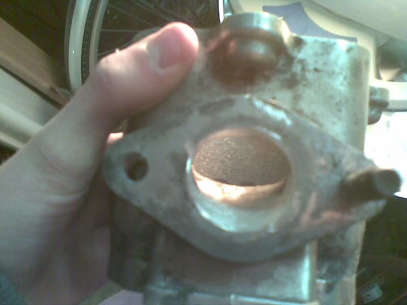

    First time doing it :emb:
    To save the pain. If it is totally shocking just put "lol"
    anywayzzz

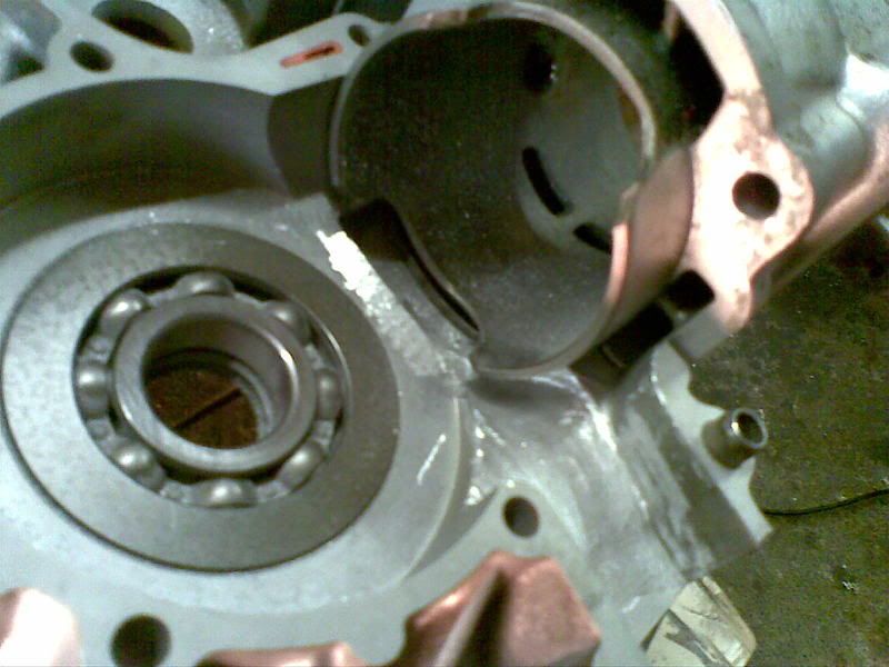

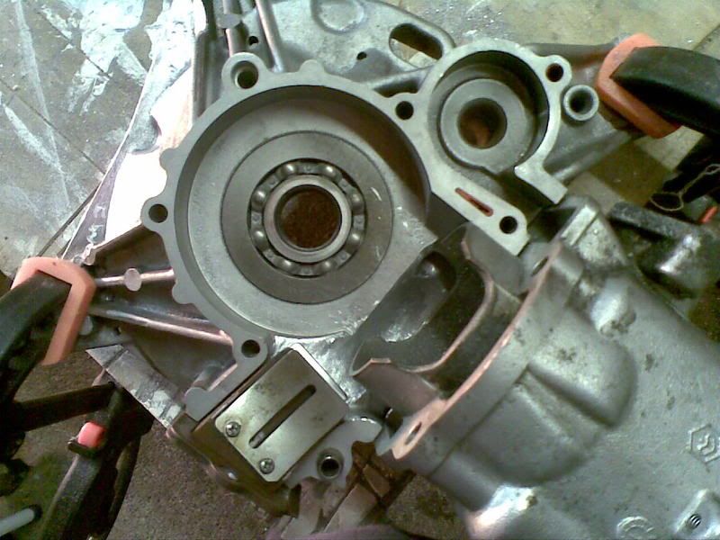

    not bad m8, too high up on the reedblock area (put a reedblock in place, will see where to start the curve) deeper and get rid of the corner in the transfer feed, should be a progressive curve right up to the tip of the feed (where it meets the barrel) still beter than the so called euro pro's did ha ha ha
    now to try and widen the transfer feed... where it gets REAL fun

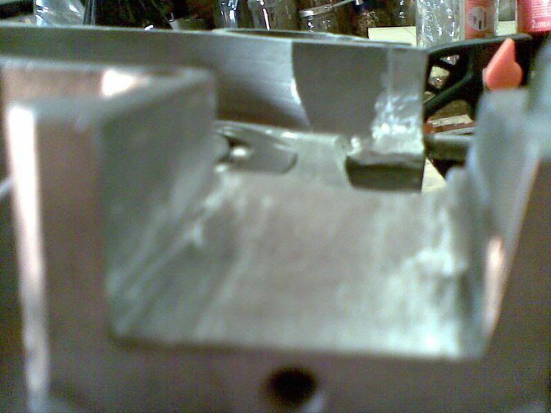

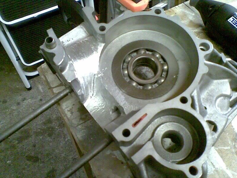

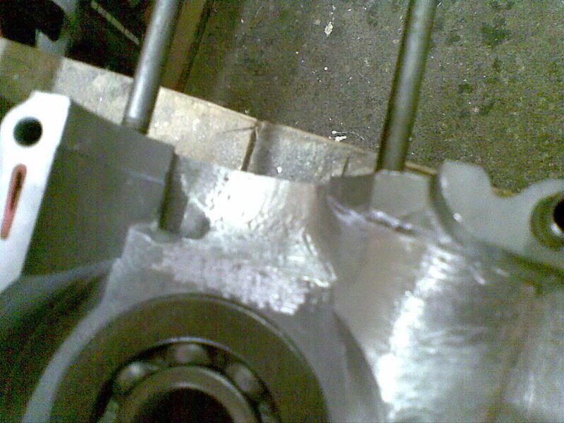

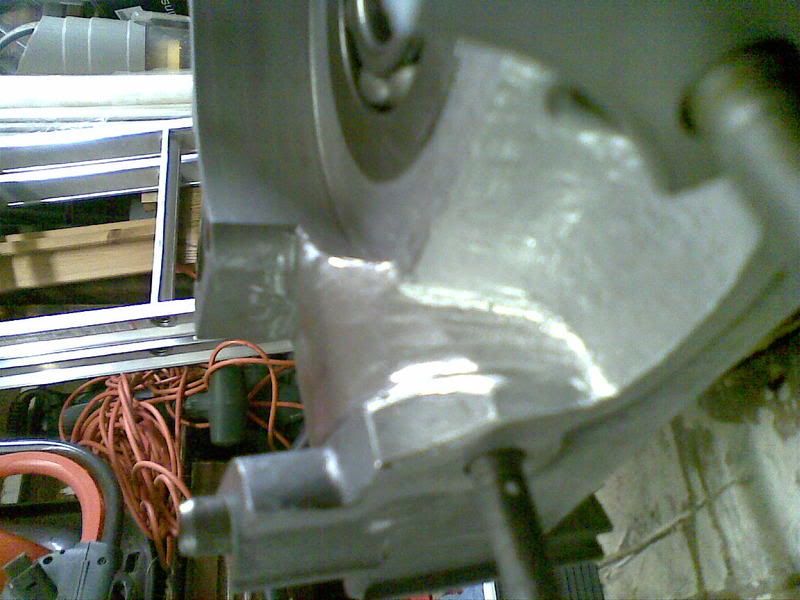

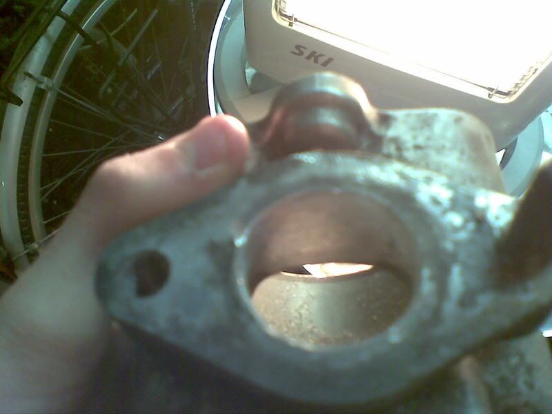

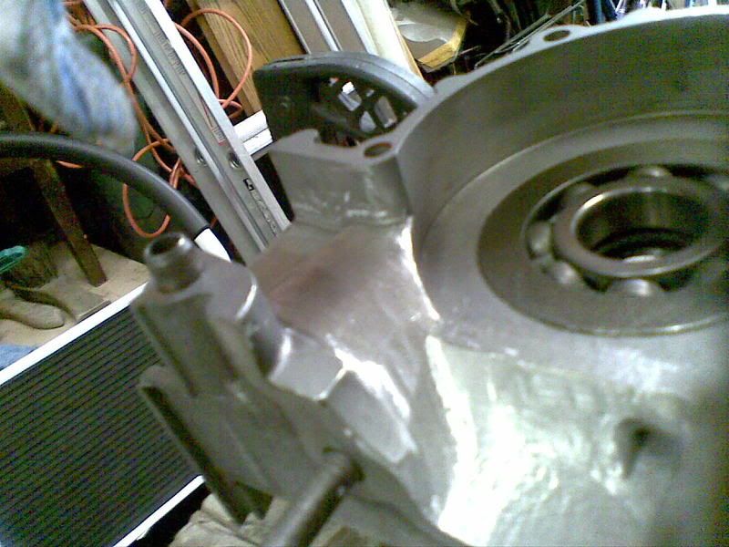

    Right, I managed to get a 180 barrel to fit onto 125 cases :D
    I got rid of most of the hump where the inlet is. Left a little bit as I wasn't to sure if to take all of it away?
    I made it a bit wider where it drops down, and deeper. I went through to the stud and was like LOLWTF

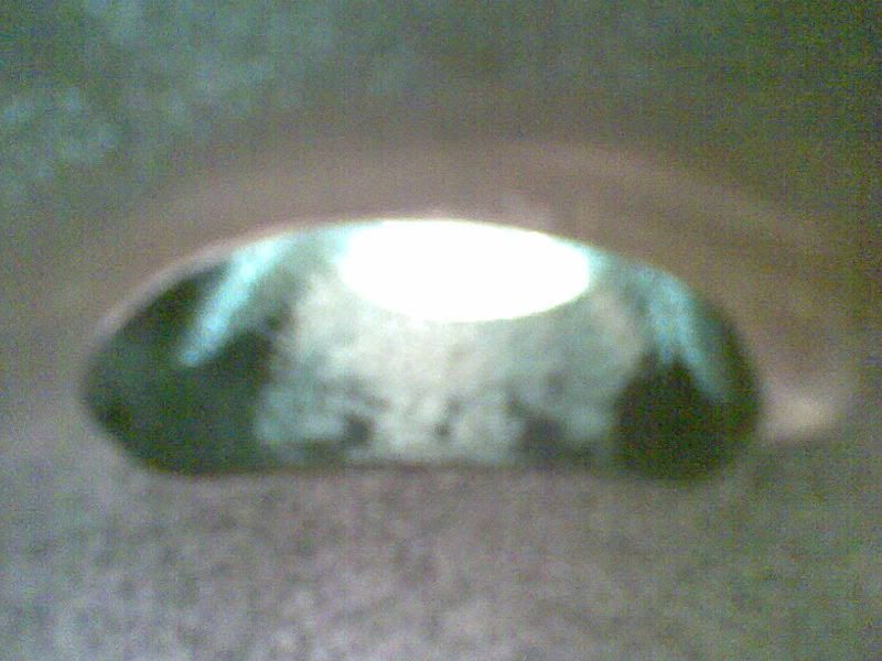

    I raised exhaust port on 180 barrel by about 1.5mm and made the exhaust outlet (wtf is it called? lol) where it meets the stub HOOOGE but within reason so gonna match the stub.
    I made the auxiliary ports (i think it is?) bigger an matched them on the cases as well :D
    Piccys. Sorry they're shite, shitty camera on phone.
  9. MiNoR cOnFuSiOn
    TOTALLY ignored what i said... you DONT grind behind the reedblock, it basicly looses compression with FUCK ALL gain in flow, if anything its now worse. case work is fine if your beginning, as for jumping on a barrel without even a clue what bits what big mistake

    Sorry I didn't understand. When I ask you for confirmation on exactly what bit to do you normally tell me to read it again. So I did, didn't really understand but I didn't wanna piss you off.
  11. MiNoR cOnFuSiOn
    well look, put the reedblock in place, push it open and look through it, be the air moving through the case.... whoo saaaa
