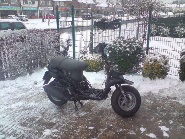

    new vid, still boggy as fook after full throttle, now off to change jet down see what happens :)
    pics in the snow
    video
    :thumbsup:
