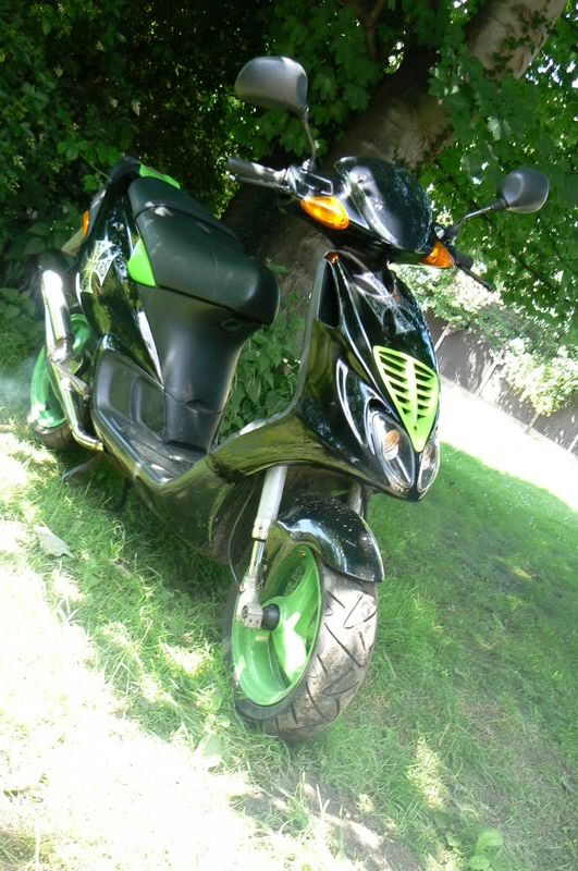

    Right, Bought NRG (MC3 50 DD Water cooled)
    And it hasnt been on the road for like a year,
    And Needs Mot, But neve rhad any experience with bikes before I Dont know what is required on the Mot test,
    So can anyone give me tips, Advise etc on whats on the Mot test and any other tips... By the way eres my bike
    Thanks in Advance...Matt

    all lights must be working, no pitting on the forks, the fork seals must not be leaking, tread should be visible over the whole tyre, if you have mirrors fitted they must not be cracked, brakes should be working fully with atleast 1.5mm? of pad left, exhaust shouldn't exceed 90decibels, rider controls (mostly throttle) shouldn't stick, brake levers you should be able to fit 4 fingers on there, should be safe to use on the road (no pointy objects or lances on it), petrol tank shouldn't leak, well nothing should leak, bearings on front and rear wheels should be in a servicible state. think thats it if anything is wrong or missing feel free to add.

    So No pitting on the forks?, Do you mean on the chrome shiney part or the lager painted housing the chrom shaft goes into ?,
  7. wobbly_trials
    the chrome bit, pistting isnt really an MOT item so long as they dont leak
