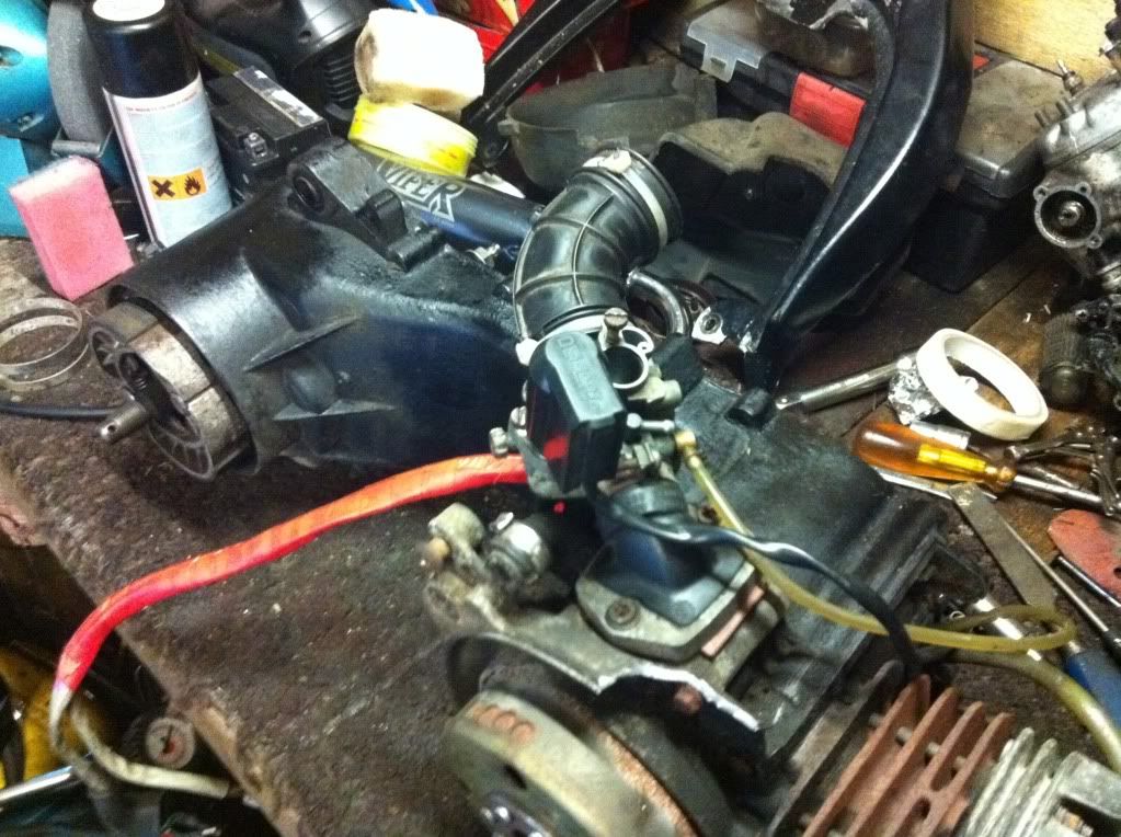

    Well as some of you will have seen i got myself a 2000 piaggio typhoon and today started to strip it down and see what i had to work with. Well after pulling the engine out i found it was very very dirty and full of crud and oil so all's that was done today was engine strip, clean, rebuild
    heres the engine before

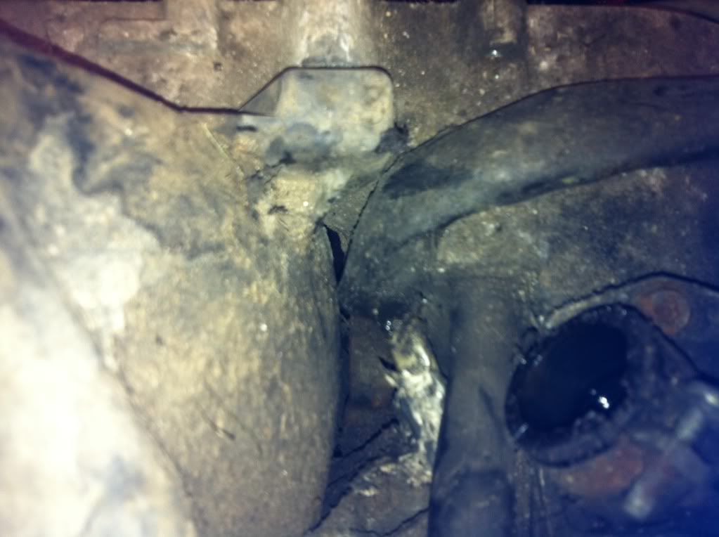

    found a peace of broken case so had to cemical metal it back together

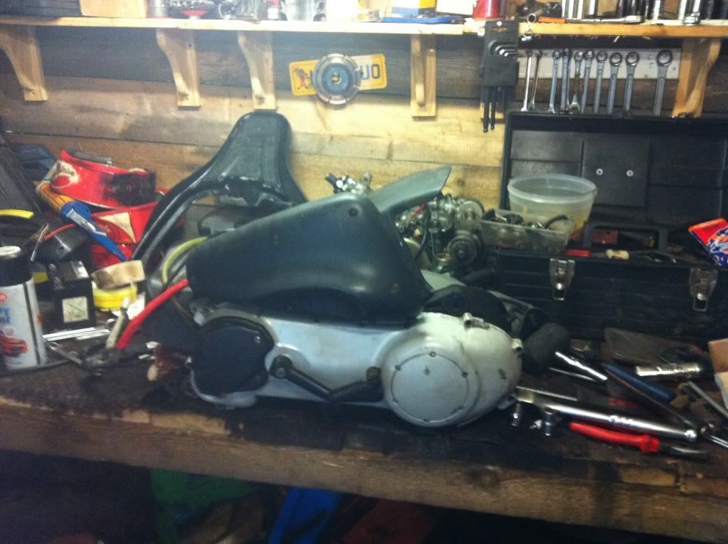

    heres the engine after with a nice black spray job on the casings

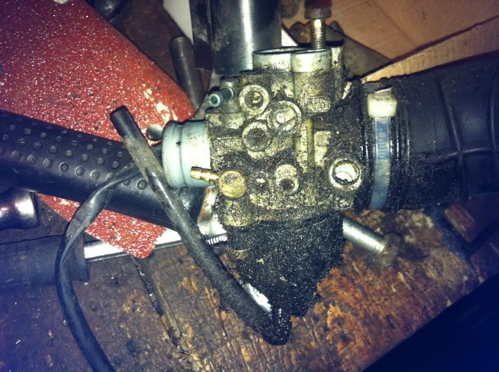

    The carb was also very dirty (found it was a 17.5m dellorto not sure if they come standerd) heres before
    and after
    i also found this in the carb took it out thinking it was a restricter (was i right in thinking this)

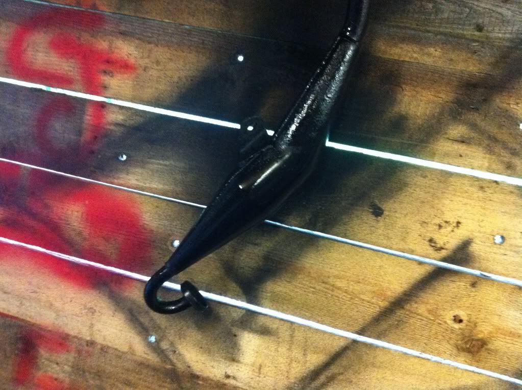

    also gave the pipe a going over with wire brush and quick lick of paint

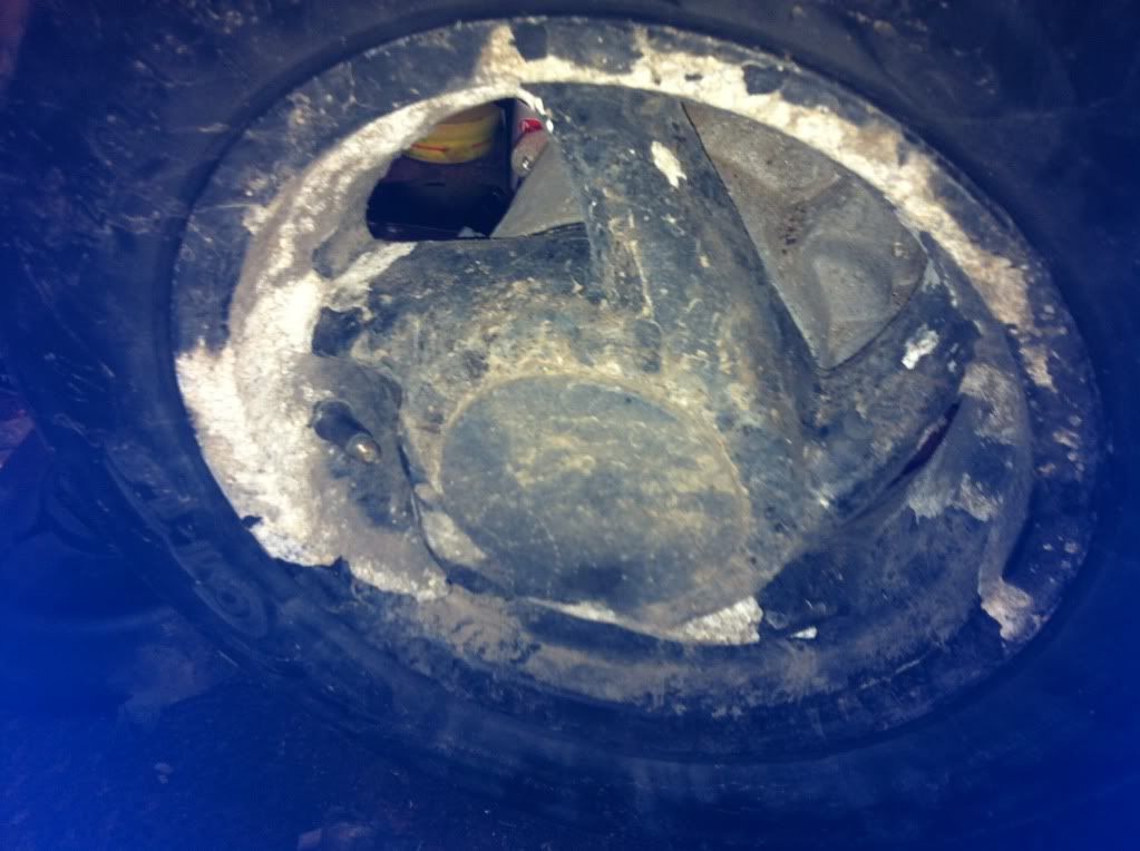

    only find left to do now in rear wheel as its in a real state

    Good work man, looking toward to seeing this done.
    That brass plate isn't a restrictor, it directs air onto the emulsion tube/jet, but apparently with a sports exhasut it's best to remove it ;)

    cheers for the reply and well will try it with and with out and see whats what

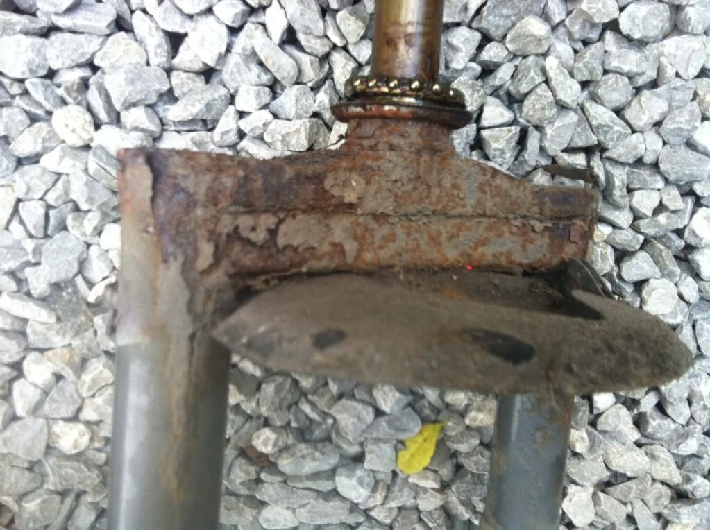

    well yesterday decided to start work on the front end and found the forks was stuck solid and was full of surface rust, after a bit of banding, jumping, hitting there free but very stiff so time for a rebuild on them
    here's them before a clean

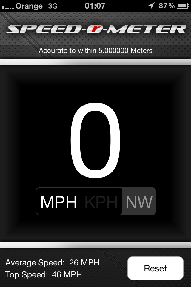

    after i had put it all together i put it away as a frind turned up so after a few hours on the ps3 he was going home so i thought seeing as it was half 12 haha and gotta say for a standerd 50 its pritty quick topped out at 46mph on s flat road :) and i got that speed from my gps pics to prove haha
