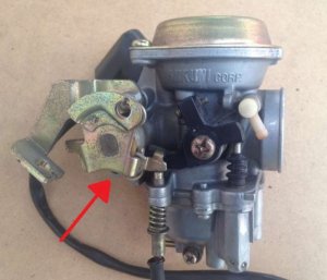

    Can you confirm the location of the mixture screw?
    The only 'screw' (which looked like an adjustment screw) I could find on it was 3.5 turns out and located on the left side (throttle cable side) of the outlet. See pic below.

    That's the tick-over screw, the mixture screw is probably on the other side and does not stick out but sunken in to the carb body.

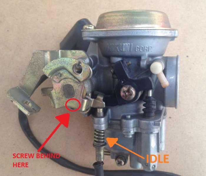

    The red arrow is pointing to a recess in the carb body behind the throttle cable holder where there is a screw (this isn't my pic nut downloaded from the net).
    I have tweaked my picture :)

    Yes, tick-over= idle, and yes that could be the mixture screw, that is an old scooter, the pre-leader engine was lovely motor I no cos I had one for a while, smooth as butter!
