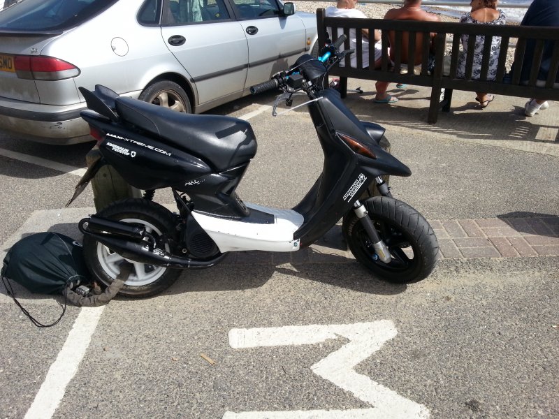

    2013-08-02 15.15.54.jpg This is the current setup-
    Polini sport 70's kit with raised exhaust port
    Leo Vince TT
    21mm TNT Carb with open Bell Mouth
    Malossi MultiVar with 5 gram Roller weights
    Stage 6 Racing Drive face/Front pulley
    PM TUNING adjustable clutch with the blue springs in! 107mm clutch and Drum over standard 105mm
    Top Racing [rimary Gear up kit +56%!
    Top speed my clock says is about 50mph and bike wheelies quite easily!
    Let me know peeps!
