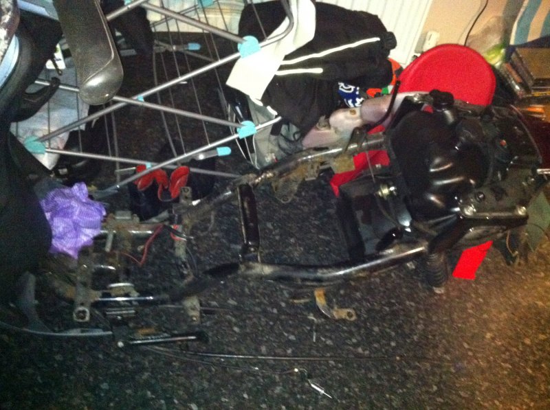

    Below is a pic of where I managed to walk it to the day the engine seized...
    Just now put the ped in the front room, where the R1 has been resting since about September 2011...
    It's too cold outside, so I'm gonna set to on taking the ped's engine out, or atleast make it more accessible for getting the cylinder head off, to see what kind of damage has been done when it's seized :(

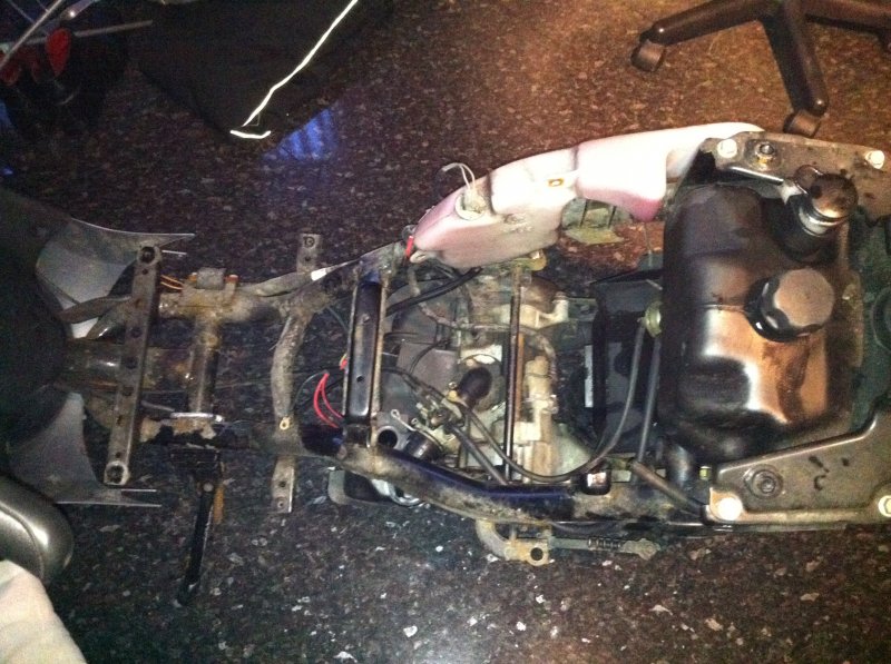

    Heres a few pix of removing the engine...

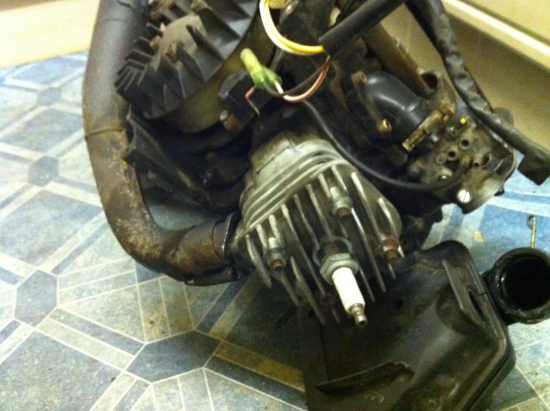

    Just took the cylinder head off & removed the piston...
    Looks like the little end needle bearings have given way :(
    The bore is quite bad too, so looks like a new cylinder kit is required. FFS!
    All this has happened from the exhaust not having any bolts in (they vibrated loose due to my fault) :mad:

    Doesnt look pretty...

    wow :D how is the bore?

    THAT IS FUCKED!! Time to Lc me thinks.
