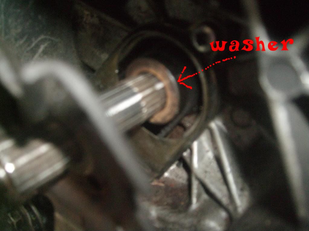

    right i gotta malossi vari. wen i went to put it on the teeth on the back plate dont catch the spline on the crank wiv the washer. so it jus spins freely is the spline on the crank ment to go big and small :confused:cratch: [​IMG] cheers for ne help
  2. MiNoR cOnFuSiOn
    your missing the SPACER
    stock dont use them, malossi do... second hand parts are never worth what you pay for them

    sorry i have got this spacer [​IMG]
  4. MiNoR cOnFuSiOn
    ye thanks for that.... now ignorance aside you need a SPACER ASWELL as all the washers... messure the var tube, its shorter... ramps on the backplate are ALOT steeper hence it sits further forward

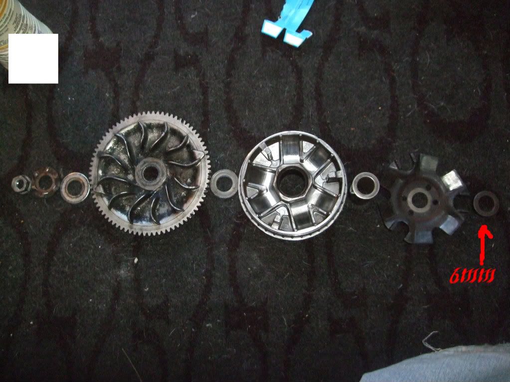

  12. karl172
    karl172 New Member
    219
    runner 172.kx 125
    ok i didnt say that i was gonna remove ne of them spacers thought u said i needed another 1 ne ways heres mine layed out lol [​IMG]
    i was jus worryed bout the teeth on the variator back plate not lockin on to cranks splines but if u say they dont matter shall i jus wack it on like that
    cheers
  13. TyphoonLagoon
    TyphoonLagoon New Member
    223
    yes wack it on like that with all the standard washers how they was and that thick washer at the back ;) then tighten it up and tell us how it goes

  15. MiNoR cOnFuSiOn
    your missing a spacer... on the crank sits the oil drive gear, a washer, a spacer, the backplate, variator shaft, variator, another washer, the front pulley, another washer, the starter dog then another washer.... IF your running 125 rolers (19mm as opposed to the 180 20mm) you move the washer from the rear to between the shaft and outer pulley (so therewss 2) if the splines dont lock to the teeth somthings worn. ether the crank or the variator backplate. ether way its not needed as like people stated they dont have teeth on polini ones.. some outer pulleys dont even have teeth and run fine (its about correct nm on the nut)
    alot of confusion in this thread (mostly me being an arse) like i said tho i can put a pic of ALL the parts in the correct order for both 125 and 180 rollers. it DOES matter and 1mm washers DO make ALOT of difference to performance and belt life. the 2 pulleys HAVE to be in the correct place for optimum performance.
