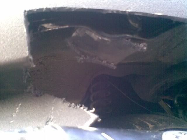

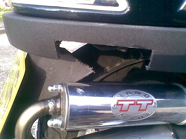

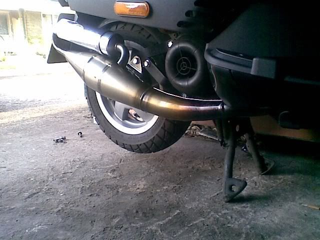

    ok, slight difficulties fitting the TT, it went on fine, had to hack away a load of plastic as it was fouling and banging on the trim and part of the mud guard holder.
    now when you go over bumps it bangs on the steel frame / body.
    is there anything i can do about this, it goes so much better now!
    would i need stiffer suspension or a high jacker
    I might have to get someone to cut the end off and re-position the end can some how?
    not the neatet job, but just wanted to see if it'd be ok
