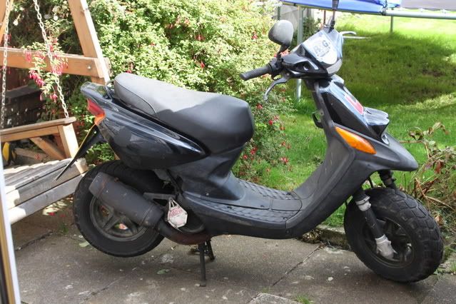

    Ok so I picked up the bike last night and im pretty chuffed with it. At the moment it dosent run but i think thats only down to 6month old petrol and a flat battery.

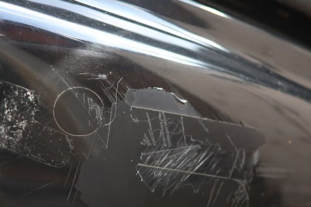

    Just pulled off all the stickers and realised why they were there. Paint is peeling off underneath. Oh well gonna be re-sprayed soon anyway.

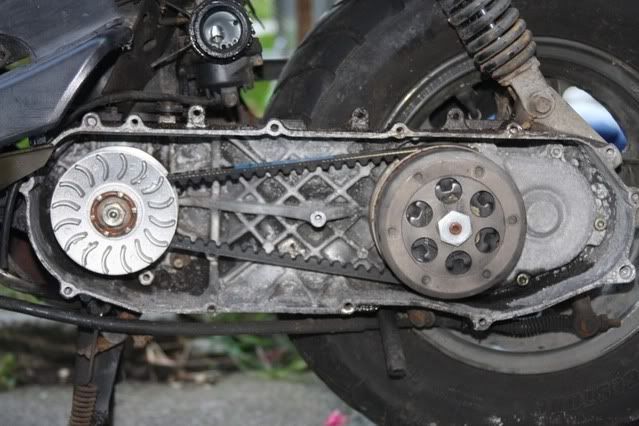

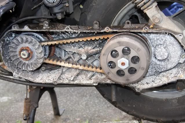

    Fitted a polini super speed kit as the transmission was trashed. Still not got it running yet, i need to check the spark and replace the fluids but its off to a good start.
    the goods:
    Before:
    After:
