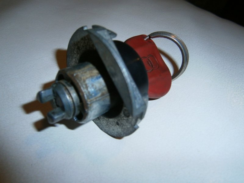

    Anyone know how to get the barrel out of the outer shroud on a runner?

    is there a sire clip holding it in mate I no there was on one had

    I figured it out. There was no clip. There is an o-ring around the barrel just inside where the key goes in. You just need to firmly push from the opposite end of the barrel to where the key goes in. It needs to be pushed fairly hard to get the o ring past the black plastic shroud. I had the key in and in "on" position when it came out but not sure if this is necessary.

    ah yea that was the same as mine but mine jt had a clip holding it in to
    glade you got it out ok :)
