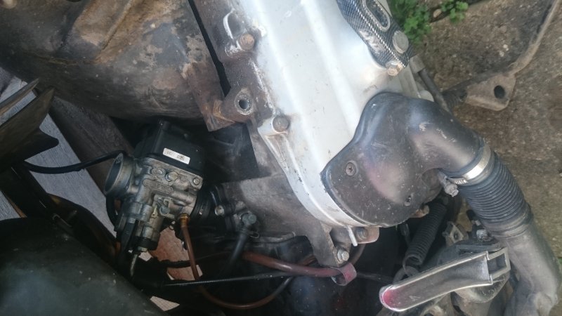

    Right i got a typh 125 fully standard with a a/c rolling nut engine wana do a lil project on it to keep me busy in my spare time i crashed it like two months ago cracked my carb my throttle and all that was fucked to including most of my pannels ive started to sand them down to be resprayed a nice dark blue i had to replace the carb couldnt find a standard one so i baught a dellorto 25mm with oil feed just for the time being needs to be jetted tho not realy sure what jets to put and i redone the throttle cable and splitter but its not realy working properly needs some work

    Ill put some pics up soon of the bike right now an my progress i got the bike running right now but its not running correct anyone know what main and pilot jet i need for 25m carb with airbox ?
  3. scootzmadness
    Nobody can tell you exactly what jet you need, every bike is different. The best way to do it is to buy a pack of jets and start with the biggest, working your way down until its perfect.

    Finally got round to ordering a new throttle cable and jets got a new inlet to due to my other one splitting so should get down to jetting soon as they come through
  16. East10ryder
    East10ryder Member
    32
    Right my inlet cables and jets Come through got round to doing up the bike it's all running now think I still need to mess about with the Jets got it running with no filter think I'm gonna keep it like that for the time being got a Mallossi head and barrel of a friend just need to order a piston and that can go on the bike what will be the best piston to get?

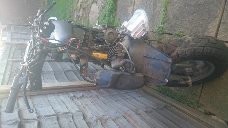

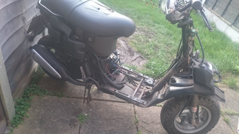

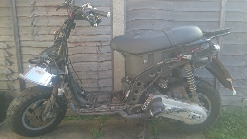

  19. East10ryder
    East10ryder Member
    32
    That's the bike as it is just put panels in for a spray job gone for a dark blue colour

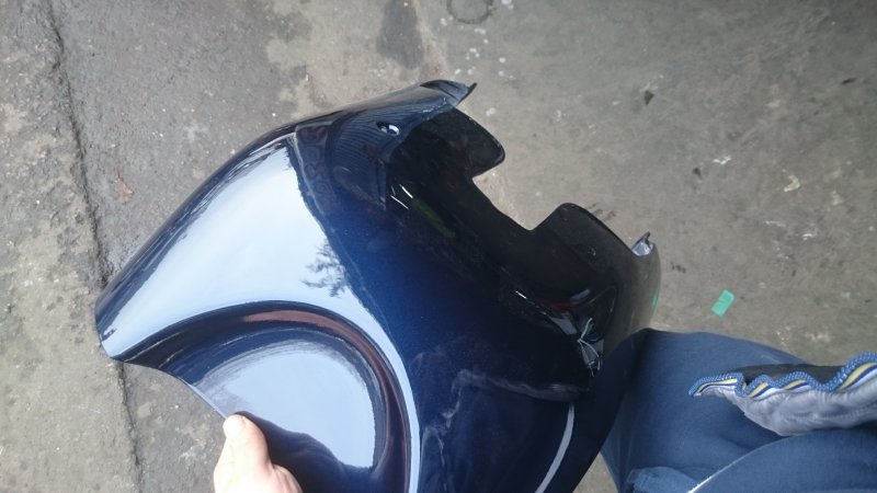

  20. East10ryder
    East10ryder Member
    32
    Little preview of the colour of the panels should have all them by the week then just need to get round to getting a piston
