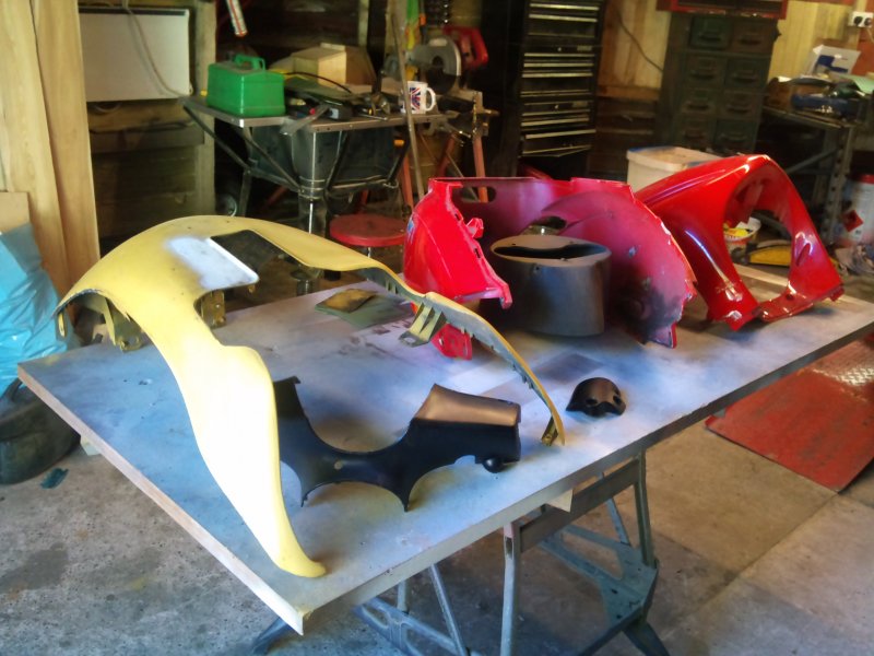

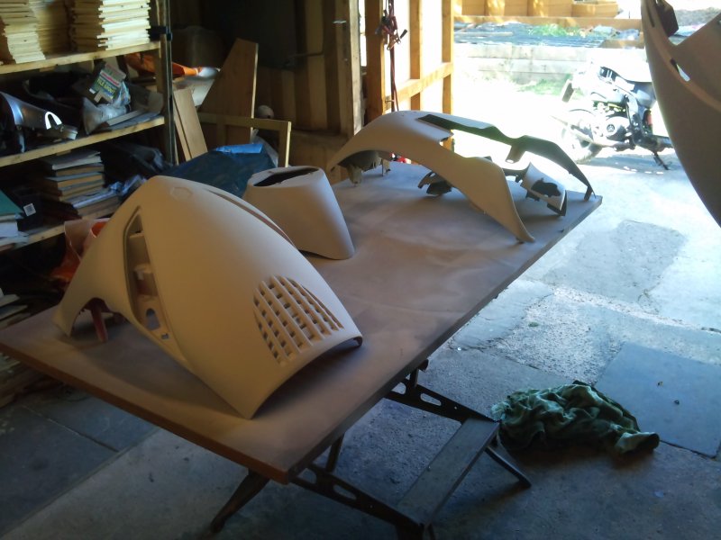

    Started the day looking like this:

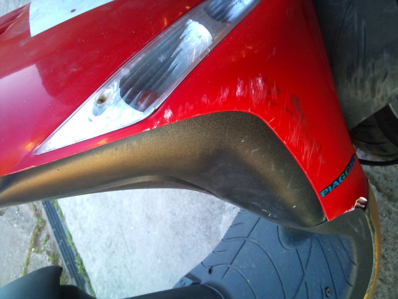

    The usual scratches in the usual places, couple of cracks, and a small piece missing out the bottom near the front wheel.
    45 minutes later:
    Got a spare front mudgaurd so will paint that then put it on after. As anyone knows the screws are normally siezed on these things.
    HoHum,
    rub rub rub,
    sand sand sand,
    plastic weld that bit,
    bit of filler on there,
    sand sand sand,

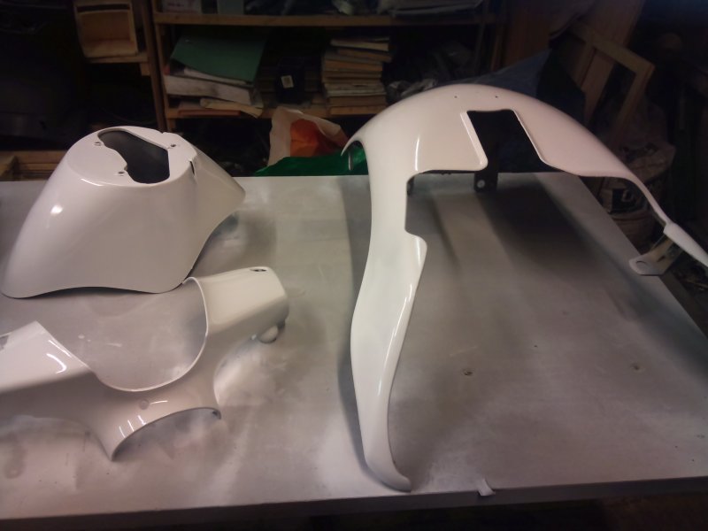

    PRIME

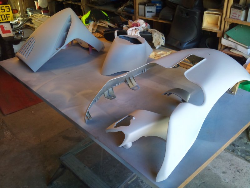

  2. Stevep
    2nd and 3rd coats of primer on.
    Had a little mishap; the screw fitting on the paint bowl for the spray gun snapped, had to run next door and nick the neighbours

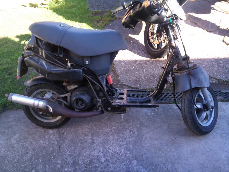

  3. Stevep
    First top coat
    I'll let these cure for an hour, then put the other bikes away for the night.
    Carry on tomorrow.

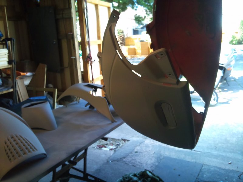

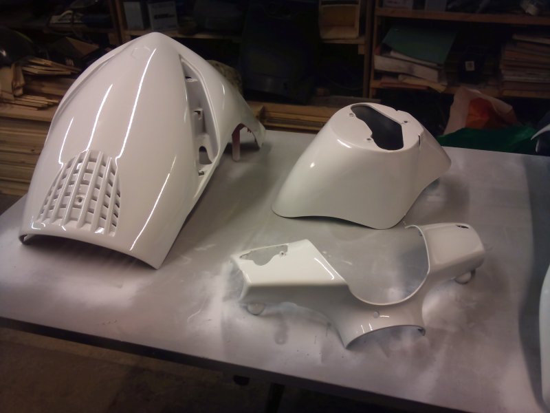

    Got 2nd and 3rd trop coats on now, laquered.
    In between all the painting, nearly finished stripping the landing and stairs for re-decorating and cooked the dinner for the next two days. Nice Brisket joint.

    Front mudguards on, replaced the three retaining bolts with hex headed ones and nyloc nuts, so much easier to get off in the future, stripped the forks out, cleaned them off on the wire wheel and now hanging in the garage after being sprayed, also sprayed the inner plastics, footboard, knee board, rear mudgaurd etc, seat panels are in position, made be go hmmmmmm.............maybe the decals are a little too big..............photos later.............maybe...........
