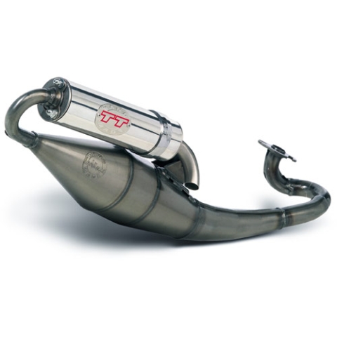

    ROAD LEGAL E-MARKED Complete sports system with a polished alloy silencer and brushed steel end cap.... hmmm thinking of buying this pipe. anybody have or had this pipe could u tell me what it is like and if its worth the 80 pounds? :confused:cratch:

    I have one on an LC 50 and as a budget exhaust it's okay............... but don't confuse it with the high end exhausts.

    You should get the Giannelli Extra instead ;) or the reverse if you budget can stretch :) Or if you can find it, because i managed to get one, the Giannelli Rekord

    I had the zx, the one up from this and set up properly is made a BIG diffrence, but if you plan on tuneing the rest of the bike get something better mate

    The TT is an ok budget sports pipe for 50cc or something like a polini cast iron 70cc :good:

    Thanks for the fast replys boys :good: think im gonna order this 2mo. wich would be the best way to set it up?

    around a 5% upjet, maybe a tweak on the mixture screw, lighter rollers and possibly stiffer clutch springs ;)

    how did ino that was comming lol, the pipe came with some so ill use them as see how it goes

    i got that exast one only thing i can complain about is that the uncromed body corrodes quick i rode mine for 39 mins and at the start if the exhuast at the engine it went a briown colour then black and then silver best thing is to sray it with high temp exhuast laccer
