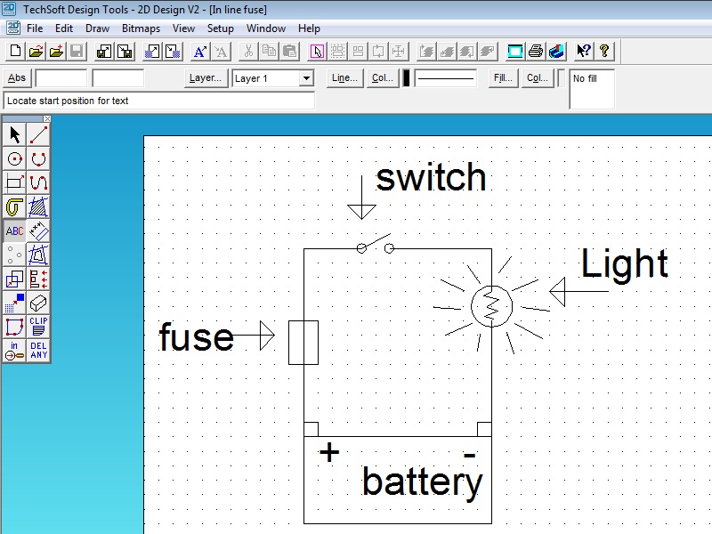

    I do not know 'official' symbols but iv'e drawn a quick diagram that I hope will help you. Untitled.jpg

    If they where running fine from the sidelight power supply they will run fine off the battery.
    All you need are these:
    http://www.ebay.co.uk/itm/Waterproo...4?pt=UK_In_Car_Technology&hash=item3a6d23d02c
    http://www.ebay.co.uk/itm/Blue-12V-...arts_Vehicles_CarParts_SM&hash=item4ac0330749
    and some wire :)
    It is quite a simple job to do, would be much easier then having to find a separate power source that will have to be replaced.
    I personally like to use switched with lights in so that you can tell if the switch is closed without having to get off the bike and having to see if the lights are on :)
