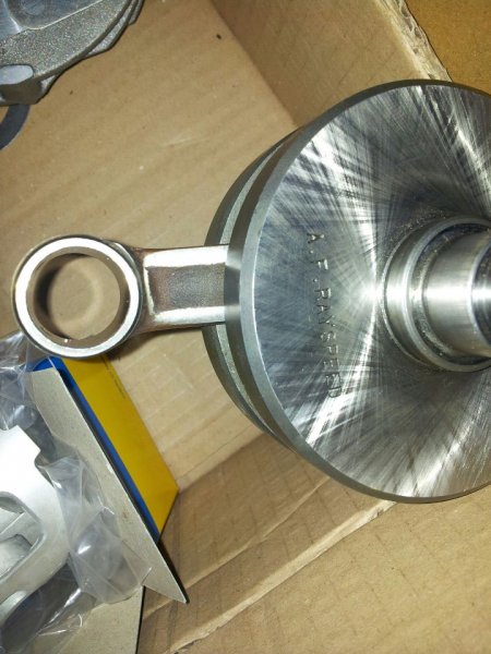

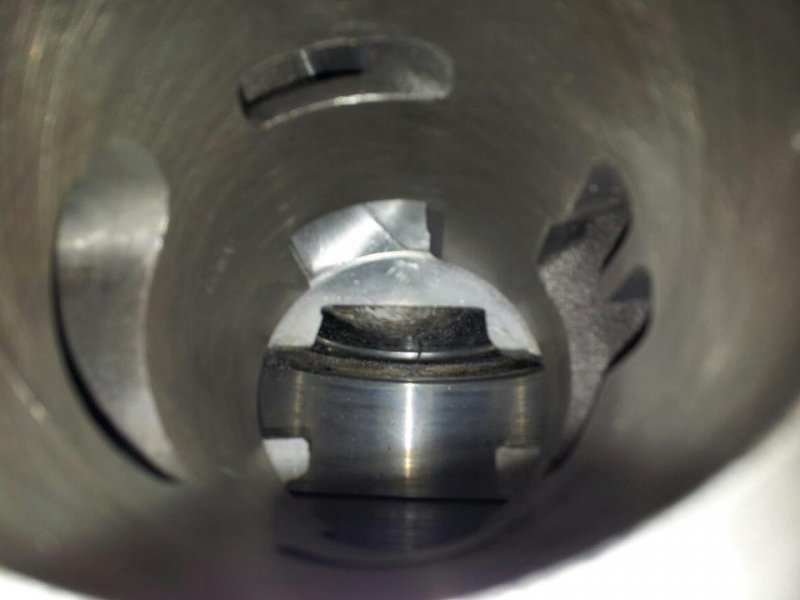

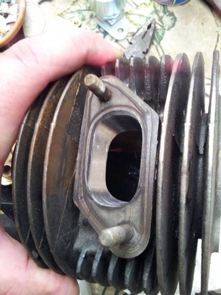

    matched casings, ported barrel - inlet , exhaust , transfers and slightly altered port timings. gt3.jpg gt2.jpg gt1.jpg

    Nathanael Active Member
    473
    nice neat work. Do you know what the original timings were? quite curious as most of the vespas etc seem to have peak torque very close to tickover

    hi think they were 176 exhaust , 128 transfers and now they are 173 exhaust and 124 transfers. Its a gt 186 barrel with AF Rayspeed crank , 30mm phbh dellorto and a franspeed race pipe.
    I will be changing the top end over to an imola some time in January whilst I do some more work on the gt barrel.

    Nice work ! Remember to chamfer the ports a bit !
