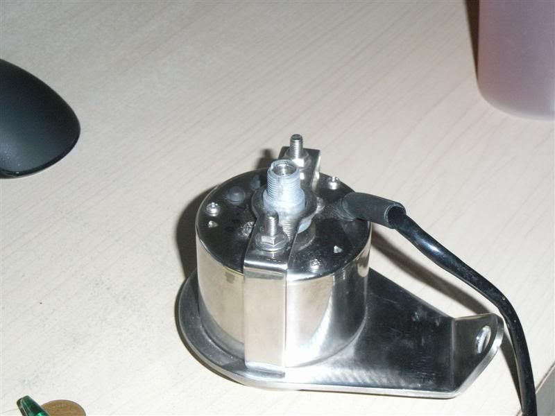

    Okay, if somebody has used one try answer the following-
    does THIS fit THIS or THIS for Gilera runner 125vx? :)
    I didn't get instructions with it and I don't have any speedo cable to try it out on and it isn't on the Koso website :rolleyes:
    Cheers
    Rick

    it should do as the cable housing on koso looks to be the same as the runner clocks

  5. MiNoR cOnFuSiOn
    koso clocks use the speedo but the fitting's are actually higher, meaning the cable is a right old stretch to get on... it will go but you need to route the cable a little differently (in some cases you need to rotate the speedo drive round and fix it in the vertical p[osition) will soon see what i mean

    Runner 200
    Don't fit, cable thread is bigger. Koso said the guage is 3-4 years old. What now ?

  9. MiNoR cOnFuSiOn
    adapt it wiht a stepped thread adaptor and maybe find some cable centre you can cut to size...

    st
    Yamaha R1 speedo cable worked on my sr.. i just got a bike dealer to match it up.
