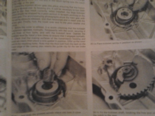

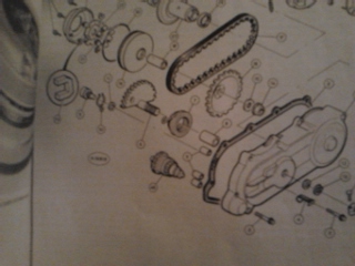

  8. Mark Emerson Trentham
    Eh?,
    Not to on the ball with more modern,but all I had to do with my ol 'ped was
    undo ©6 bolts an take off transmission cover,entire mechanism is inside the
    case itself/ once inspected or renewed just a matter of making sure it's all back
    together proper an putting it back on again.
    Heres a cple of pics to give you a rough idea.(sorry 'bout quality lights bad in here).mk.
    Boxer_Dog_2002 likes this.
