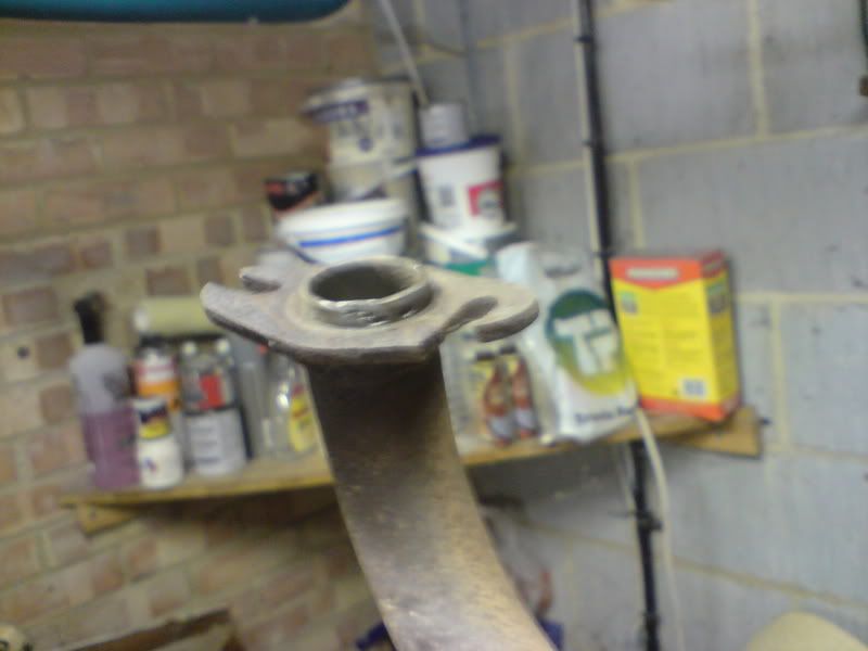

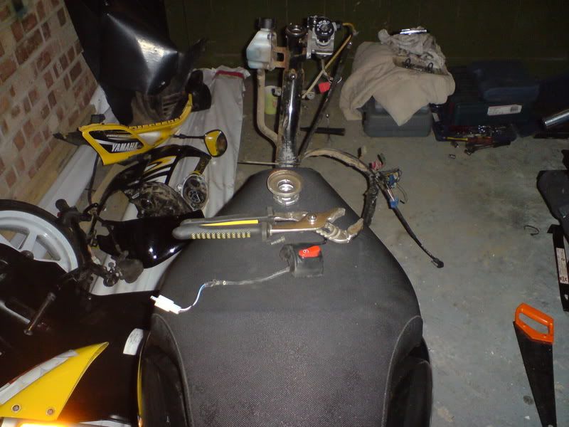

    The yoke and frame was bent enough so the wheel was stuck in one postion. you couldnt move the handle bars.

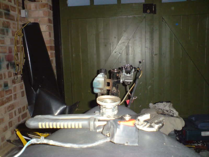

    On these pics the camera is basically square. so u can see how bent the frame is.
    A close up of where the frame has been squeezed in. You can imagin that its ment to go in a sr8 line up and its totally shagged. non repairable.

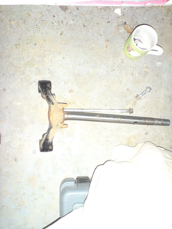

    The yokes are totally out. Ive placeed the front wheel spindel in postion where the yoke is ment to up str8

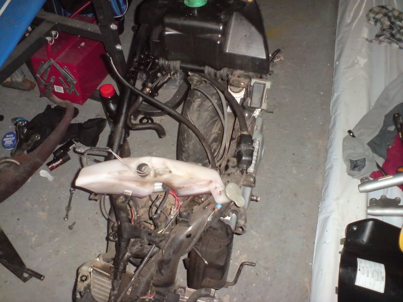

    last pictuer after day 1. (1 hour) im a busy man lol.

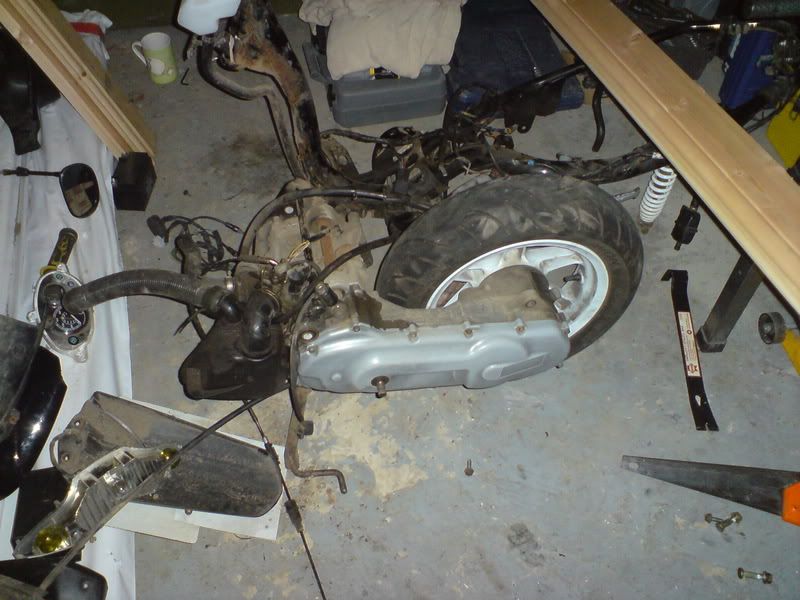

    Day 2. Taking the rest of the pannels off and starting to take out the engine.
    Day 3. Ive started on the pannels. wet n dryed them down and im going to start priming them soon. im using Plasti-Kote spray paints as ive herd good things about them.

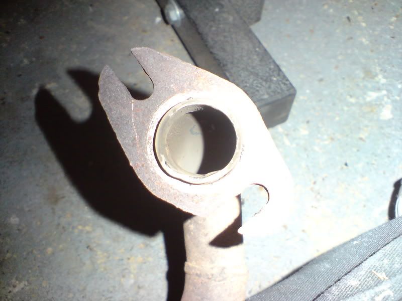

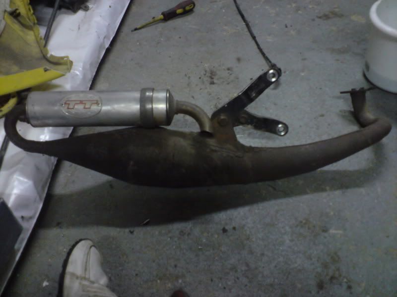

    Exhaust. Leo Vince TT exhaust. Is the cone still on this exhaust. i dont know what im looking for. if anything i would say its that part thats sticking out. i dont have a dremel. just a hammer and screw driver. oh and a blow torch. What needs to be removed to derestrict it.
    Ill keep u all updated. any1 got any ideas on paint jobs.
    also the jet size ill need for this leo vince pipe. alone with clutch springs.
    the person my brother got it of hasnt set it up correctly
