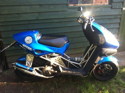

    Hi all,
    Ive just bought an Italjet Dragster D50LC off Ebay for next to nothing and im rebuilding it from the ground up, Its getting fully Tuned with every highend part going and will be just over 90cc when its finished, im in the process of modifying the case so the long stroke crank will fit along with everthing else, i will keep you all posted on the progress :)
