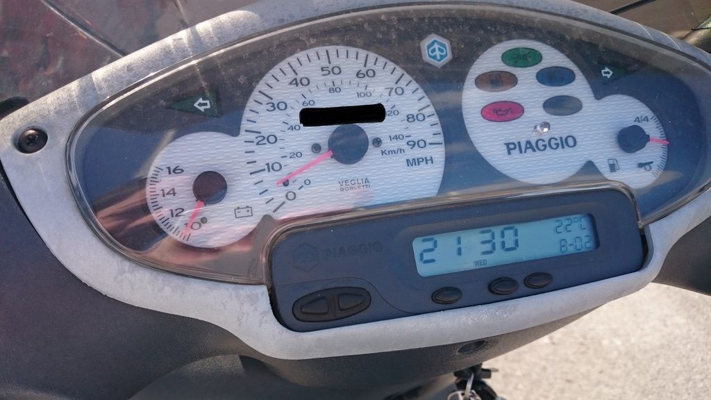

    The battery gauge has been showing as 12 since I got it but hasn't gone down.
    Today i tried starting it 5 ot 6 times and it wouldn't start which is so frustrating, the battery gauge was under 10, i checked it again earlier and it's showing as 10 now.
    I'm guessing this is a battery issue? I hope nothing major has gone wrong but it was fine when i last used it about 5 or 6 days ago.

    Just tried starting my bike, no sign of it starting, my battery gauge now says under 10. I presume it's a battery issue but maybe it's something else or an electrical fault? Not sure what to do, if i buy a battery and it still doesn't start then I've wasted money and I'll be back to square one.

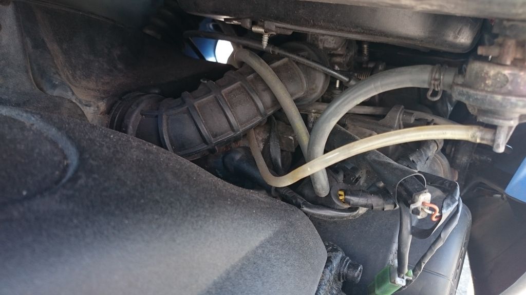

    Also, a pic of underneath the bike: Also a question, can I spray WD40 over all this? or just certain parts?

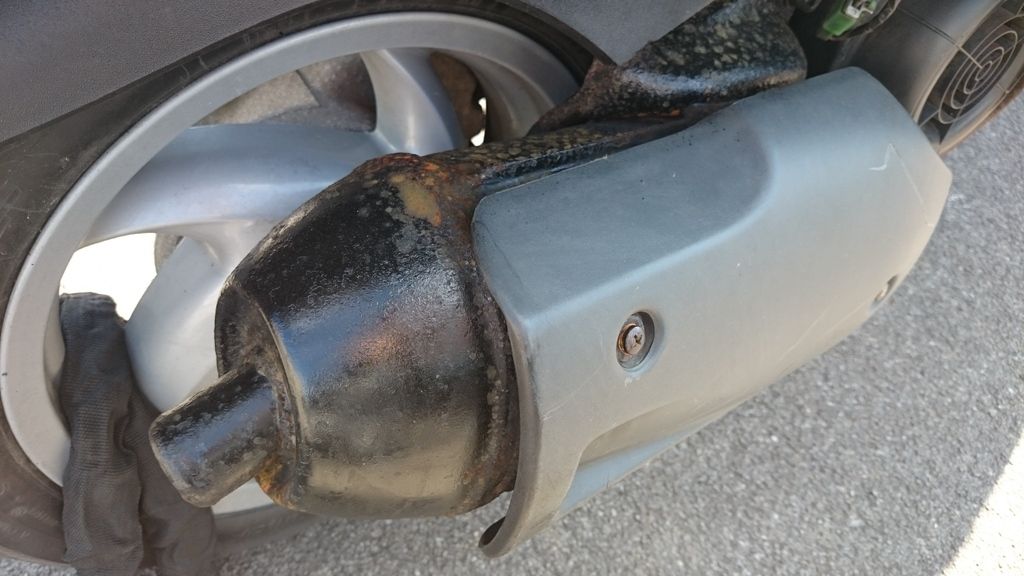

    Exhaust: Again, would WD40 help this rust?

    Electrics are funny sometimes , you will very rarely have any signs of failure before they go,either work or they don't . Should have asked the garage to do a charge check once it had a healthy battery . Maybe tidy up that bit of wiring by the fan case, yes you can spray the wd40 pretty much everywhere . That exhaust has been painted before, take it off,sand it down and spray it with some vet black , will come up lovely .

    KEEP THE WD40 AWAY FROM THE BRAKES...

    WD40 WILL BE USELESS ON THE EXHAUST BECAUSE ITLL BURN OFF, PAINT WITH VHT PAINT IF YOUR THAT BOTHERED ABOUT IT.

    Regarding the exhaust, you didn't say anything about sanding it down? Wouldn't be much good just painting on top of the rust would it?

    Obviously sand it down then paint it, I could go into finer detail about getting the perfect finish but theres plenty of tutorials on google and I cba. although if you cba sanding it there is actually a special paint you can get from wilkinsons that you just brush over and it kills the rust, cant remember what its called, ive got a tin in the shed if I get time tomorrow ill check the name of it.
    run it and ride it every day if you can. just spray the wires with WD40 it will put a film over it and give them some protection from the elements. if you cant ride it every day atleast start it up once in the morning, once in the evening to let the battery charge a bit. if you leave it for days the battery will go flat again and letting the battery go flat over and over will kill it quicker. batterys should be replaced once a year.
