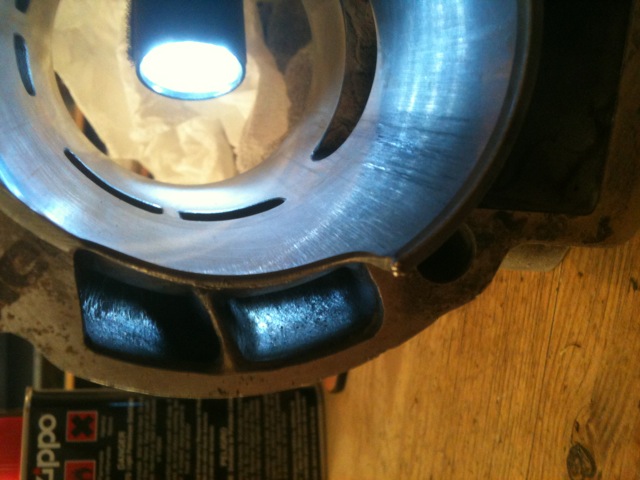

    Thanks Guys i ment flowed lol soz im still learning :blush: will get pics of cylinder bin away so aint bin on here in ages (update got pics of the cylinder hope this helps had to use a torch because my iphone is how i take the pics so its hard to get a good pic)

    Let me know if I need to take any more pics I didn't know if these were good enough tbh just rushed to get em up
  6. wobbly_trials
    looks pretty good, it would be worth popping a port map up if you can, someone like minor confusion can then see what extent it's been modified to. worth giving it a go and seeing how much difference in power it produces.

  11. MiNoR cOnFuSiOn
    ye its been ported, obviously larger inlet feeds and exhaust port, internal looks alot wider at the usually narower parts (there usually more oval) get a vernier (messuring tool) from halfords/machine mart/similar and mesure to the top of the barel. or line the top of the paper up with the top of the barrel, tape in place then take a rubbing. a greasy finger works well tbh.
