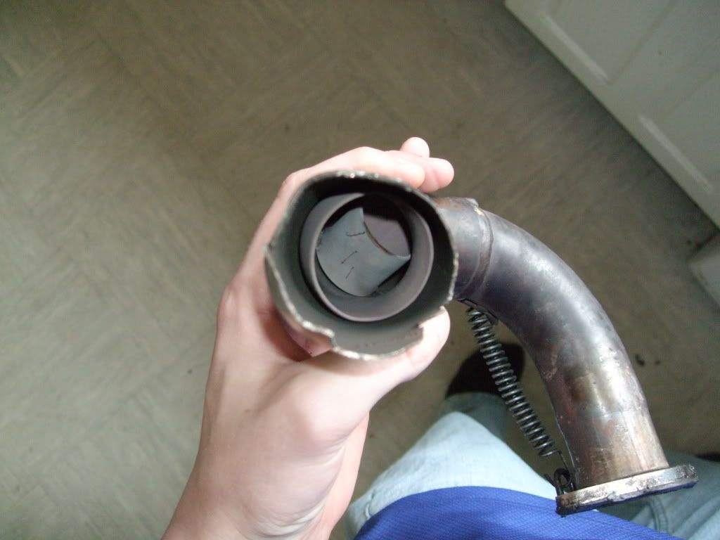

    runner 172.kx 125
    wats this is it menta b there
  2. safekyle
    safekyle New Member
    343
    Gilera runner 172
    To me that looks like a retrictor cone that has fell down ! and someone forget to get it

    its a 125 pipe aint it ? if so it cant be a restrictor can it ?

    its a restrictor

    yea its a 125 pipe i dunno if to take it out or not as it getin welded bk up soon..ne1else eva took it out

    m8 a scorpions more or less the same as a normal runner exhaust if i was you i'd take it out and let us know what difference it made :tup: :tup:

    i took it out now but never rode it wiv it in so cant say if it made a diff lol

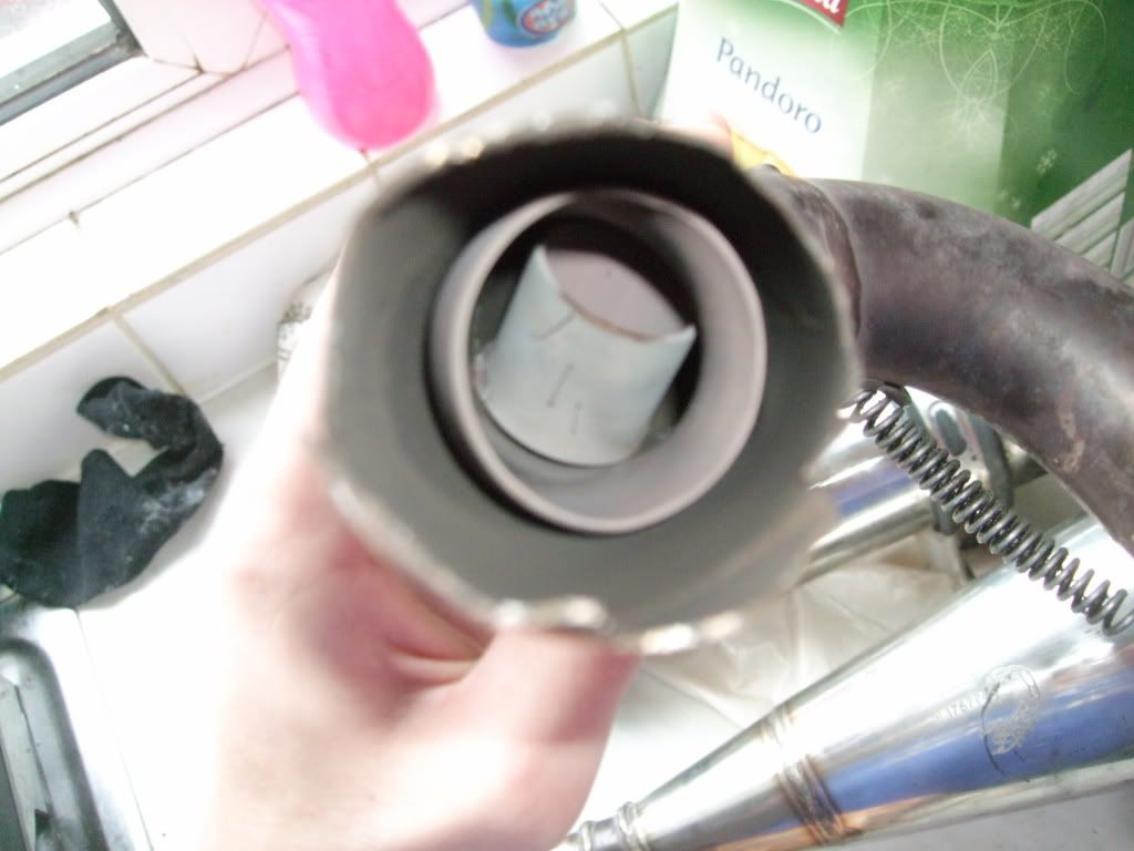

    yea welded in iv only took out the middle bit wat looks like a hola hoop wacked out pretty easy wiv good wack
    but the the biger 1 round the hola hoop lool is propa welded in wiv the join on the pipe inself
    if u eva wanted to do it your self il count the welds from the stub if there the same then u can cut it right on target n get all of it out
    saves lots of cuts try to find it lol

    Aye its the restrictor
    As confirmed by Mark at scootermatix

    well its defo made a inprovment ova my standerd pipe
    n think it sounds abit diff for a scorp but not been side by side wiv another 1 yet

    ye i knew they were restricted but never had one to cut to bits to find out... thought it may have ended wiht the horible mesh in the middle... but nope, obviously not
    id now love to try ripping this, the dirty cage and reangeling the inner section of the stinger to the centre of the pipe and see just how good a scorp can be....
