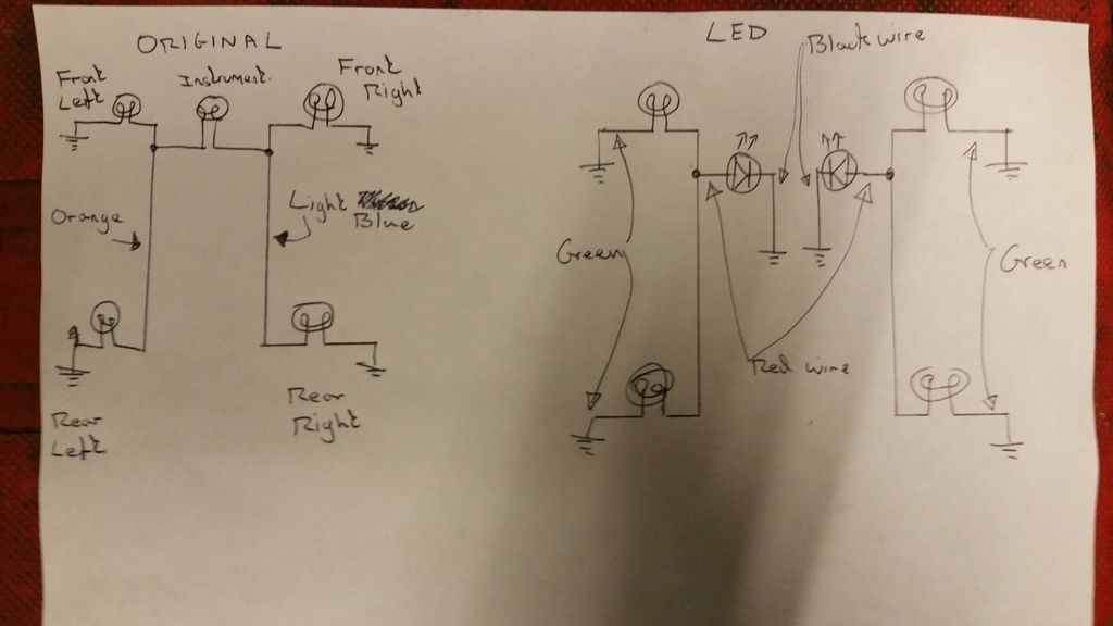

    sorted what I need is two of these one connects to the right winker other to the left

    At the moment you have one Instrument lamp with a terminal going to each side of the Indicators left and right.
    Dave i believe has removed this bulb and used two LED indicator lamps which are small enough to both fit inside the original lamp holder at the same time.
    One LED is powered from the Right indicator system the other from the Left indicator system.
    Both LEDs will have a spare lead which just needs going to Earth.
    LEDs are Polarity conscious so be sure to connect them the right way round.
    The issue AlanCF is mentioning is normally a problem with the flashing rate when replacing a conventional Lamp with LEDs
