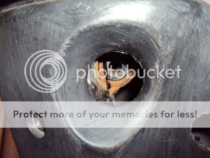

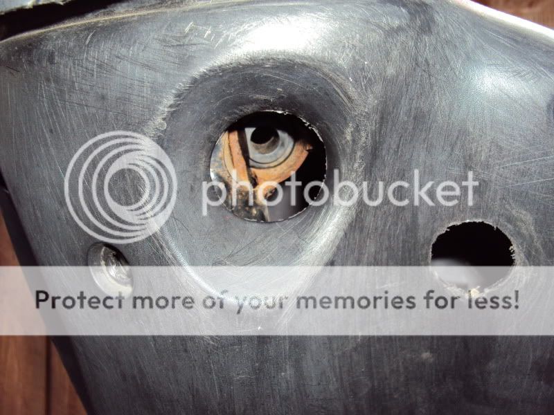

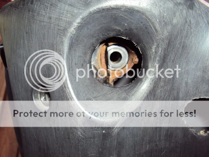

    right this is how it looks
    i have ordered a lock set but im aware i need something between the barrel and the frame tube?
    does anyone want to shed some light on what i need to do. does anyone have a link for the parts i need.
    many thanks
  9. safekyle
    safekyle New Member
    343
    Gilera runner 172

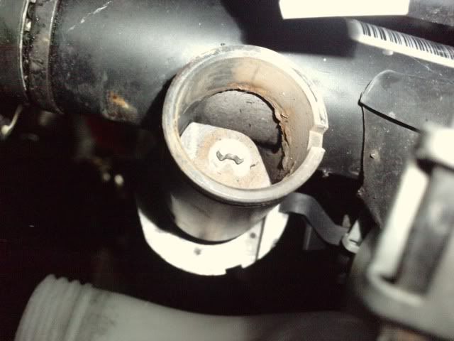

    first of all your gonna need to get the old cylinder out...
    so dremel it off or something...
    then find a welder and then bang this on....
    http://www.scooter-center.com/scowe...ERA_RUNNER125FX&category2=CAT:CAT_ERSATZTEILE
    then...a new lock set, barrel like you posted before....
    then at the front
    http://gileraspares.co.uk/spares/partImage.asp?GPN=298581
    in the middle of the barrel
    http://gileraspares.co.uk/spares/partImage.asp?GPN=298903
    at the back..
    http://gileraspares.co.uk/spares/partimage.asp?gpn=vs18957
    hold it all together...
    http://gileraspares.co.uk/spares/partimage.asp?gpn=253937
    i dont know if you need this or not it was in related and kinda rang a bell..
    http://gileraspares.co.uk/spares/partImage.asp?GPN=298838
    that should be more than helpful, if you need more ill go out and take pics for you

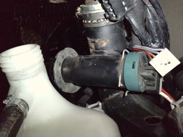

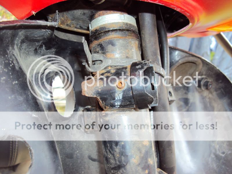

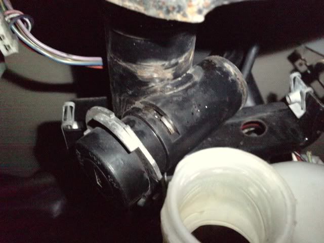

    All i took of tonight hopefully you can see from here...
    if you need anymore let me know...
