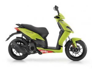

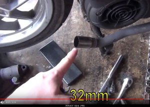

Hello! This is my bike (same as pictured), the Sportcity 125 from year 2011. The stock exhaust is a bit rusty and I am looking to replace it with some aftermarket muffler from Alibaba (not looking for something pricey for a 8 year old bike). The Mufflers all have a 51mm inlet pipe diameter, but my scooter pipe is only 32mm. How do you guys handle that? I can't fund any adapter for it. Thank you!

I guess you could shim it but I don't know what effect that would have on performance - assuming this is a 4stroke?
I would get some sort of middle pipe to connect the 2. I've done it a few times. You need a pipe that is 30mm inner and 50mm outer. Old scaffold tube maybe?
