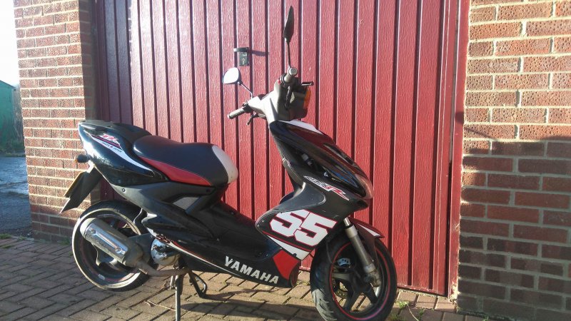

    Hi everyone, i recently purchased a aerox 2012 sp55 and is on around 25k and still on factory build so i thought id be prepared for the a rebuild i am prepared to buy whatever tools need just need to know what to do when rebuilding i have a vague idea but not 100%. anyone know of any guides or videos that are good or can just tell me thank you! 15134010_881527598651318_2033283544_o.jpg
