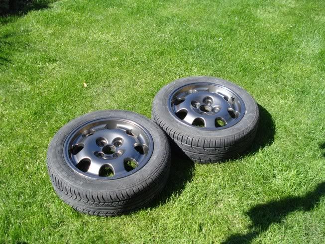

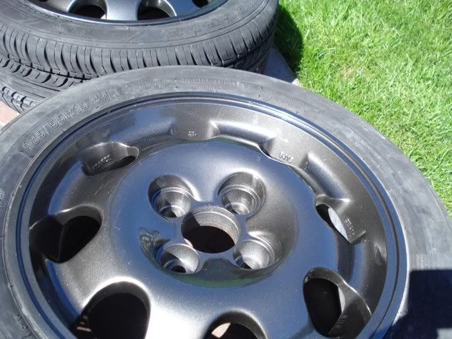

    Try to make sure its warm where/when you spray. It makes the paint spread better on the surface of the panel and also stops blooming. If the surface is rough when finished and the paint is thick enough, sand the top coat down with 2000 grade wet & dry before applying the clearcoat. Then wet & dry the clear afterwards to give a smooth finish
    You can get a decent finish with rattle cans buts its all about prep and patience
    Heres some wheels my lad did last summer with cans
