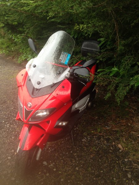

deep are going to be a pain, light scratechs can be sanded out a little then primed up with a filler primer and touched up with factory match paint. deep gouges , well your going to have to sand and fill the fender with body filler, then sand it nice and flat and re-spray the whole fender again
